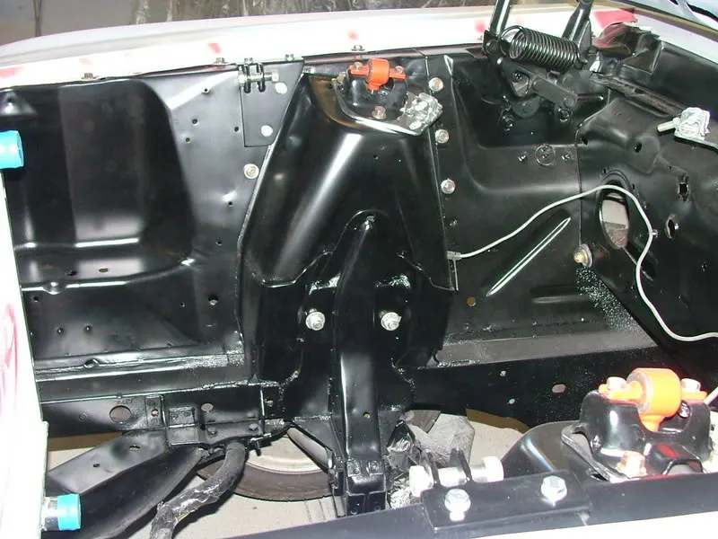

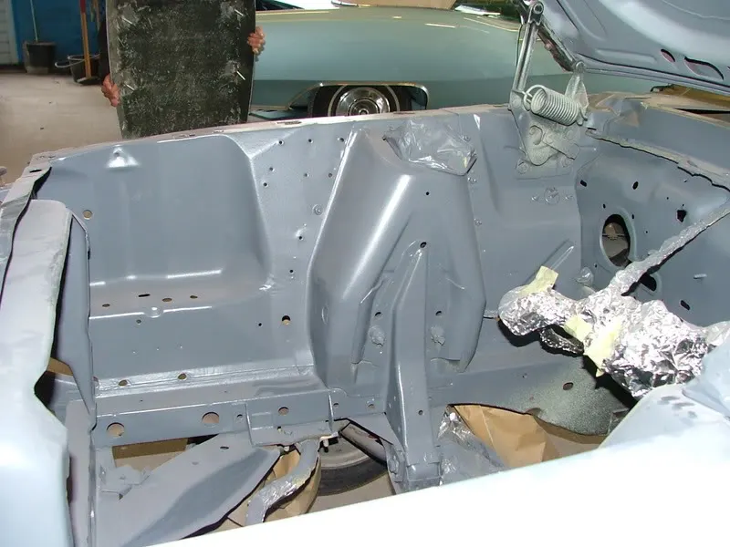

I have the Boss 302 reinforcements in my car and any space they might take away from the engine bay is imperceptible.

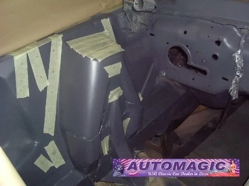

Before the reinforcements
after the reinforcements with the primer
and the reinforcements with the engine bay finished

My kit came from NPD. My towers looked like that only after my car underwent a complete restoration. Prior to that, the towers were cracked. The body shop seam-welded the cracks and installed the reinforcement kit as a preventative measure for when my NA 450+ hp 351W gets dropped in.
To give you an idea of how bad a shape my car was in before I started to sign over my paychecks to CustoMike, here is a look at the floor before it was cut out and a new one piece floor installed. You may extrapolate from this one picture to the state of my shock towers prior to the repair.
