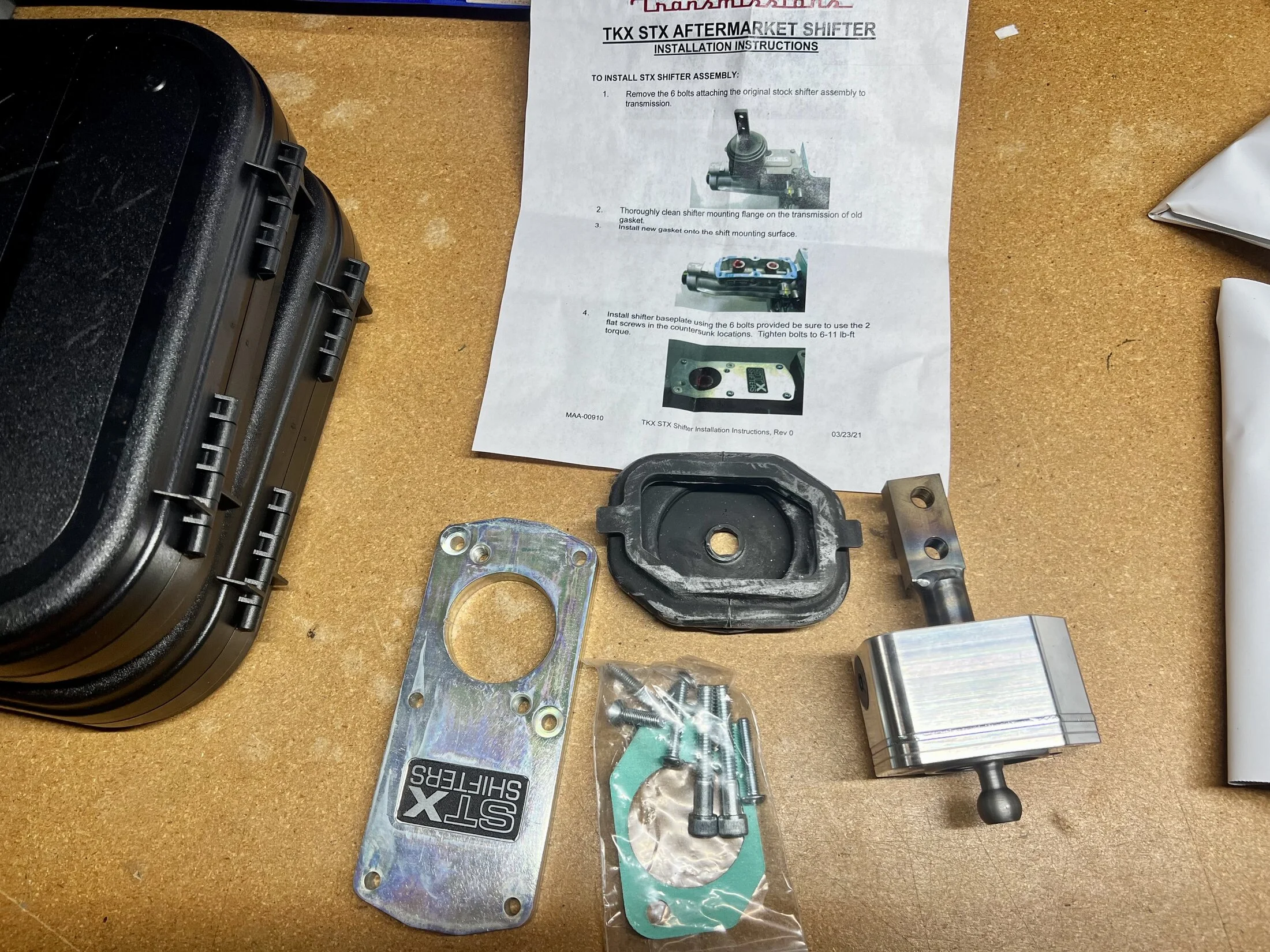

I ordered the Silver Sport Transmissions STX shifter

So you know we will expect a review with pictures...

No problem. Car is out getting a Holley Terminator X installed and a retune. I'll install the shifter when I get it back.

Shifter just arrived. definitely seems like a robust unit.

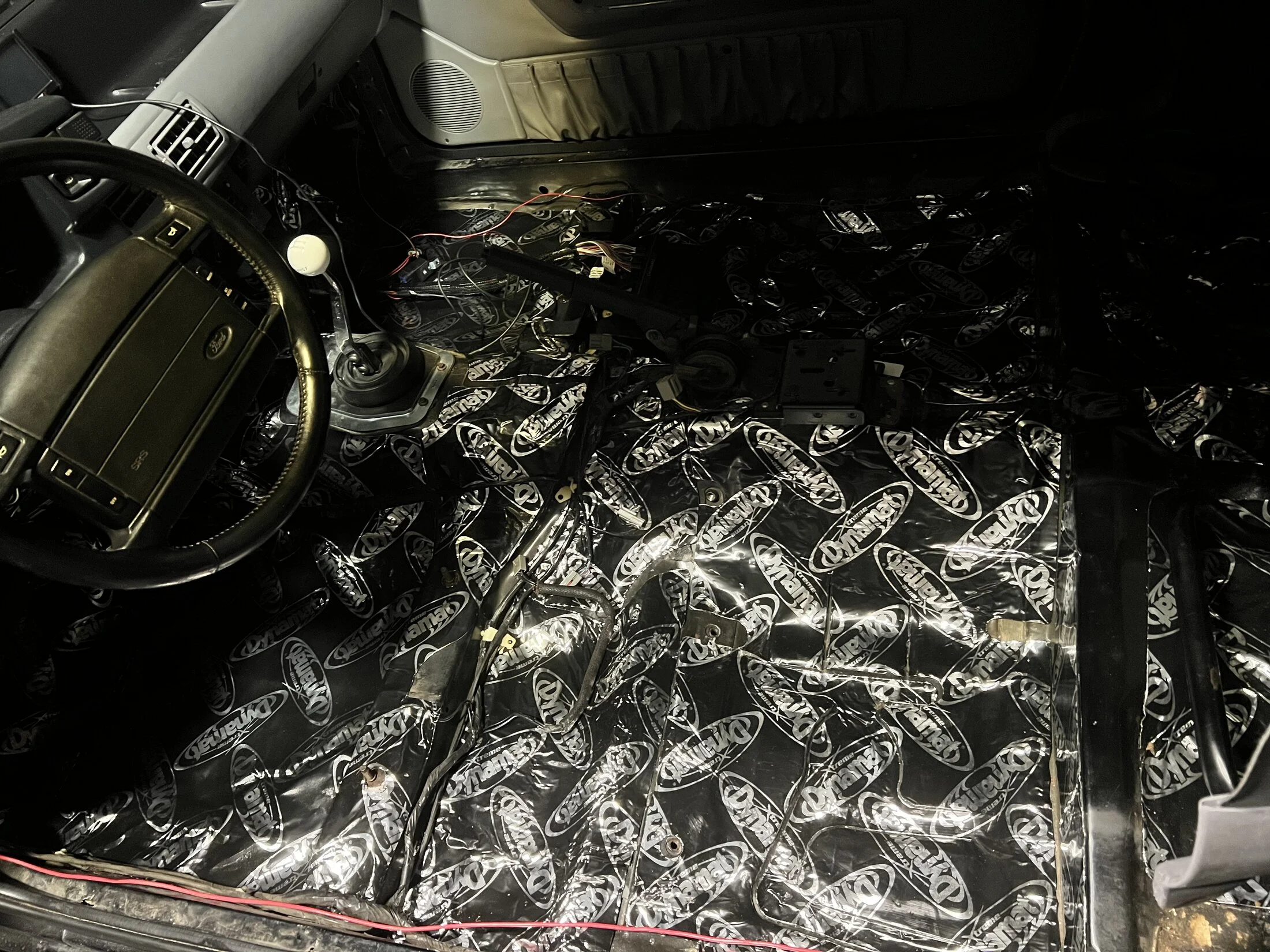

Took them awhile. I already got the STX from silver sport in. Doing it while I restore and dynamat my interior, so I haven’t had a chance to try it yet except for a short drive around my neighborhood.

Mustang5L5
Mod Dude
Feb 18, 2001
43,347
18,081
224
Massachusetts
Jan 31, 2024
  • Jan 31, 2024
Yeah surprised it took so long. TKX has been out a couple years now?

Is the blue doo hickey to move the shift lever into a better position?
Yes. It rotates 360 and uses a pinch type connection on the shaft. The shifter handle is the same way. Will rotate 360 degrees and you just tighten the pinch clamp. Gives you a lot of flexibility in where you adjust it to sit.
