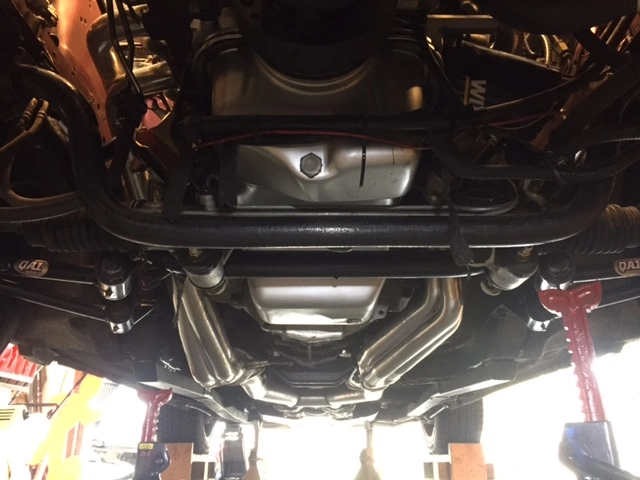

I'll chime in with this. I recently swapped out my long tubes and off-road set up for some equal length shorties with a Catted mid pipe. It took me several days plus lifting the motor to remove the long tubes. The passenger side header slipped right in with no issue, didn't even have to remove the o2 sensor. Drivers side was a little more work but very little. That difference alone will keep me from ever doing long tubes unless I build a track car.
