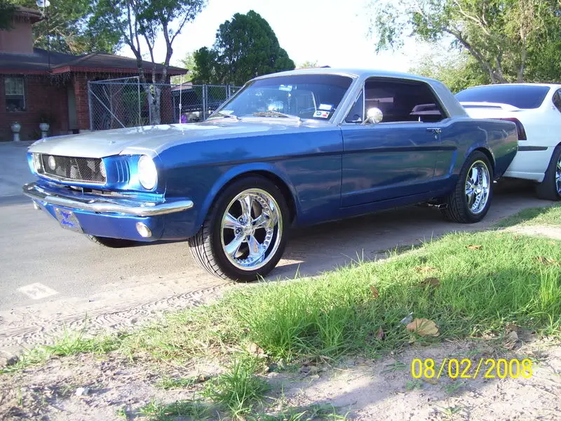

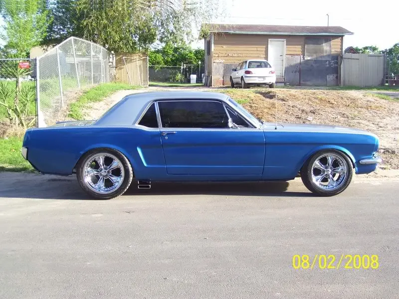

I don't think it's going a whole lot lower with that tall of a wheel and tire without hitting.

You'll want to use V-8 springs with the new engine, but when you're trimming the springs keep the cuts down to 1/2 coil or less till you get close. and remember the car is likely to "settle" after little road time.

If that car drops any more I'd worry about the wheels hiting the quarter panel at full lock on a turn. Acutally, throw a good solid bump into the mix and I'd worry about it hiting now.

sorry could you clear it up a little more don't quite understand you don't know if it is cuz I just got out of work and I'm a little tired. The rear fenders are rolled and I'm going to do the same to the front once I get it home or at the shop. It's been there since saturday because of the control arms. I thought about the tire being too tall but since the fender already cut into it I doubt they will change them to a smaller size. the manager at the store told me he would change them if i didn't like them but now being cut i don't think he will. It rubbed on the fender up front when I gave a tight turn but I pulled the fender a little out and hammered the peice that would hit the tire. thanks to all your information guys.

Don't do the drop, its just going to make everything worse. The guy at the tire shop never should have let you put those tires on that car. They are too big without the fender being rolled.
