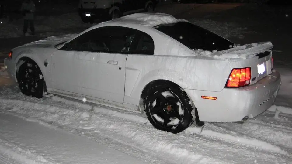

I second the nomination for Blizzaks. That car easily backs up my driveway in 3+ inches of snow. Blizzaks turn ol Whitey into Abominable SM.

A true Snow tire is the only way to go. I ran stock width winter tires in the snow and the thing still bit hard despite the width: it was insane how well the Blizzaks hooked. My wife wasn't even scared to drive it, she said it felt as sure footed as her 4x4 Xterra with the Dueller A/T's.
When you're leaving 4x4 Wranglers with crappy car tires off the line in a Mustang, in a snow storm with properly equipped tires, well that's just priceless.
When we were getting slammed with the 6 + inches and the streets hadn't been plowed for a good 4 hours, I had a Jeeper pull over to watch my wife make what would have been an otherwise impossible climb in the GT. I had her come to a complete stop, on an embankment that slopped down towards a huge ditch in one direction and turned up a long steep grade in the other---the direction we were going to over-come and she took off in the 'Stang without spinning the tires.
The Jeep guy was whiping his half top plastic door in utter disbelief as he watch the 'Stang just motor on by making the hill climb look easy.
