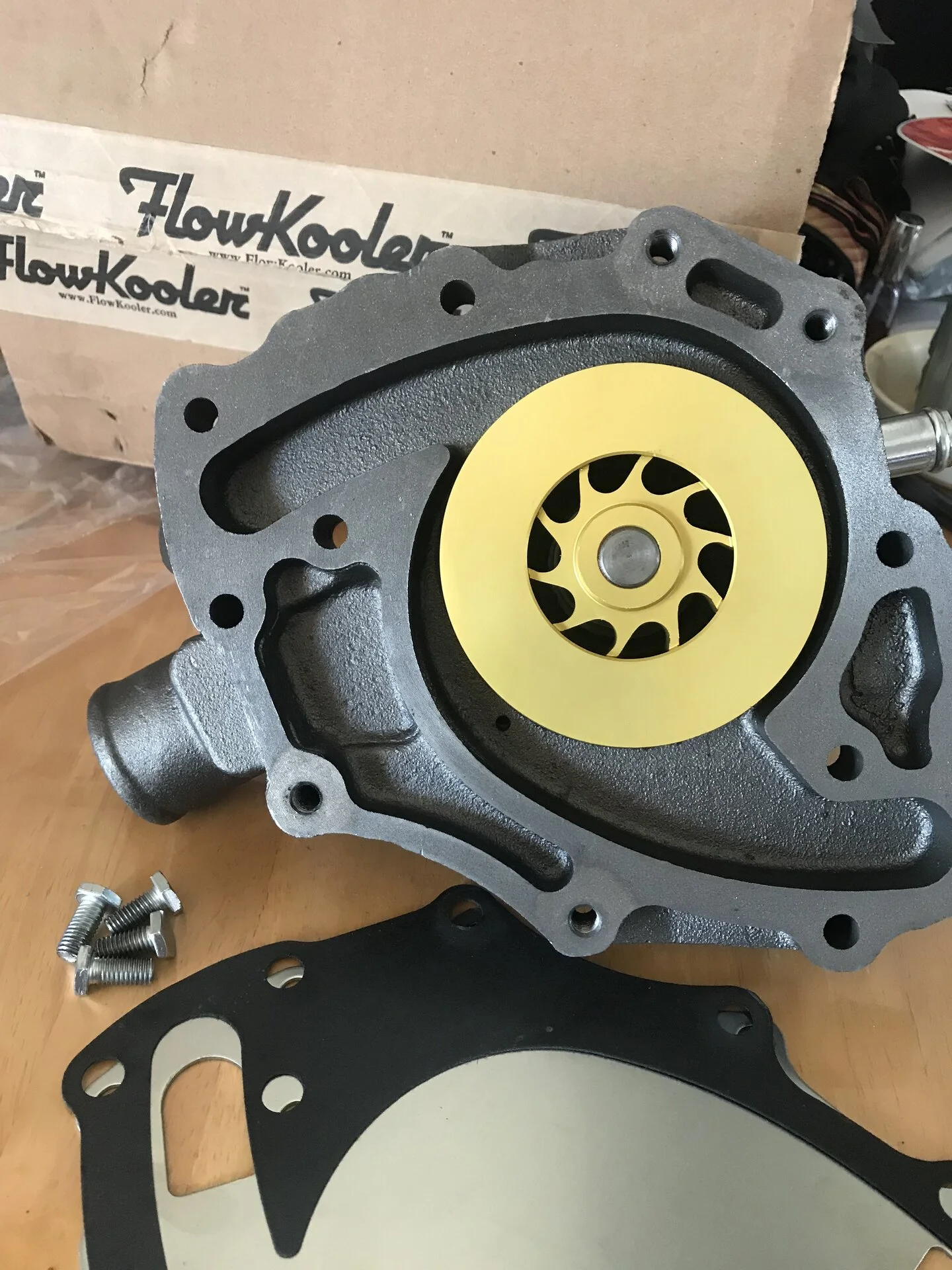

The high flow ones feature a redesigned impeller wheel. The only pumps that feature that, that i am aware of are the Edelbrock Victor Series pump Pump, and the GMB 125-1560P pump. There might be others with a revised impeller
I beleive GMB makes the pumps for Wieland as well
Edit: Flowkooler also has a revised impeller design
I have the Flowkooler pump with its fancy golden impeller.

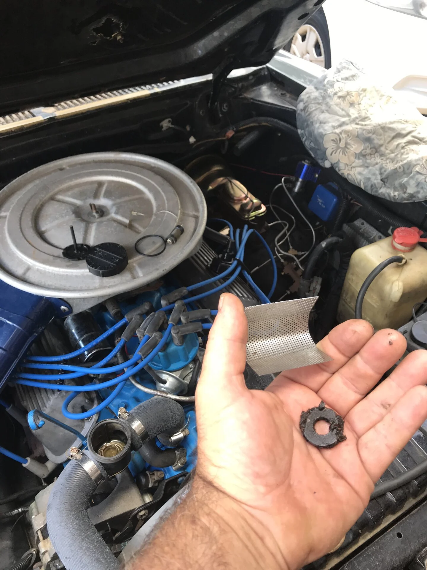

I also got the Tefba radiator hose filter. Old blocks scale some rust continuously which might make that new radiator unhappy.
It has a screen and a magnet. Magnets doing most the work and screen catching a little silicon.

at $72 for a plastic housing kinda pricey.

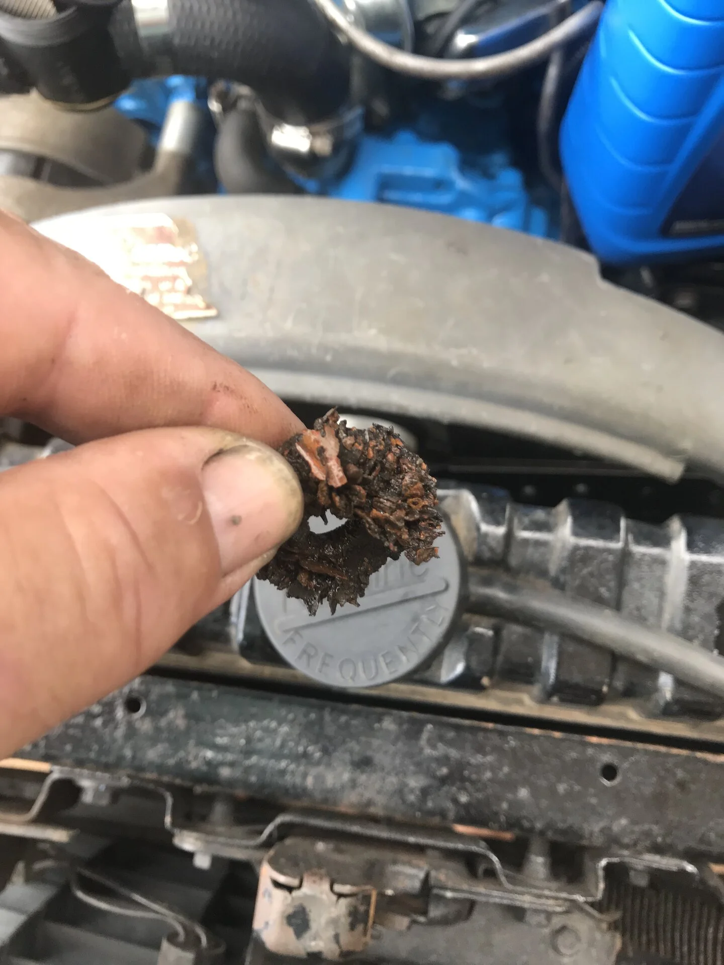

Yuppers overpriced a bit, but is radiator insurance. I've removed a 1/4 cup worth of rust scale in first year
Thats after a good chemical flushing and a back flushing of radiator when was removed from car.

Much easier to service than the Gano version.
Also got me a sacrificial zinc anode that hangs from a ring under radiator cap. Been watching it dissolve slowly over the years.
