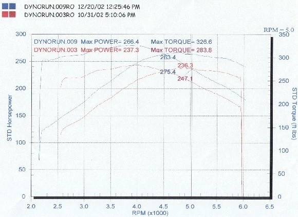

boring and sleeving the block to 5l is much better than stroking. The dyno below is from a completely stock 4.6 to a big bore 5l with stock top end.
