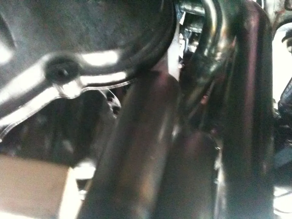

Well unlike charlie sheen, I'm not winning :(. The damn flange was touching the heads that's how close I got it but there is one huge issue. There is just not enough room between the ear on the bell housing where the starter goes and the A arm on the K member. The space between there is not big enough for all the tubes to squeeze through. I can unbolt the other motor mount so the engine raises higher but then I loose the angle of the engine twisting to one side. Looks as though I'm going to have to remove the transmission or the K member and from what each job looks like I'll be better off taking the transmission and bell housing. I took a rough pic with my phone, hard to get a pick while holding up the headers with one hand but it gives you kind of an idea. I want to accomplish something successful today so I'm going to and try and remove the bushing on the rear end and install the solid bushings.

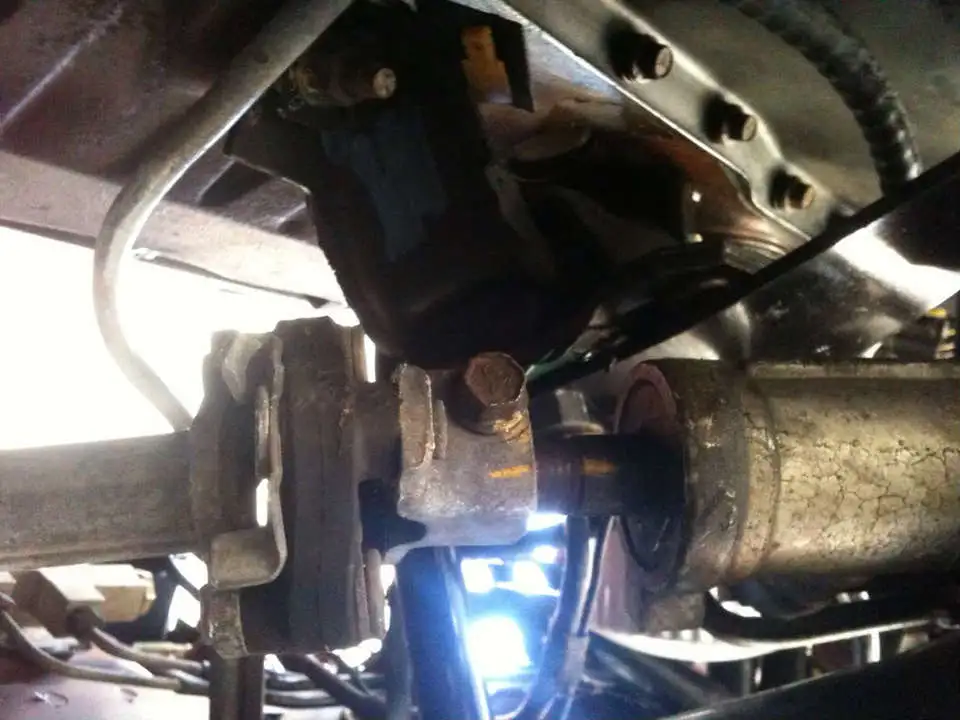

also I was taking a look at the drivers side and it does not look as bad except for the steering shaft. This is the only bolt I could see on it, is this all I have to remove to get the steering shaft out of the way?
