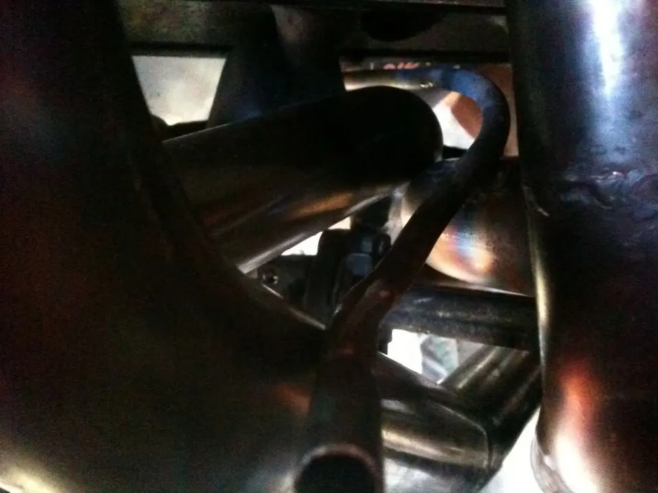

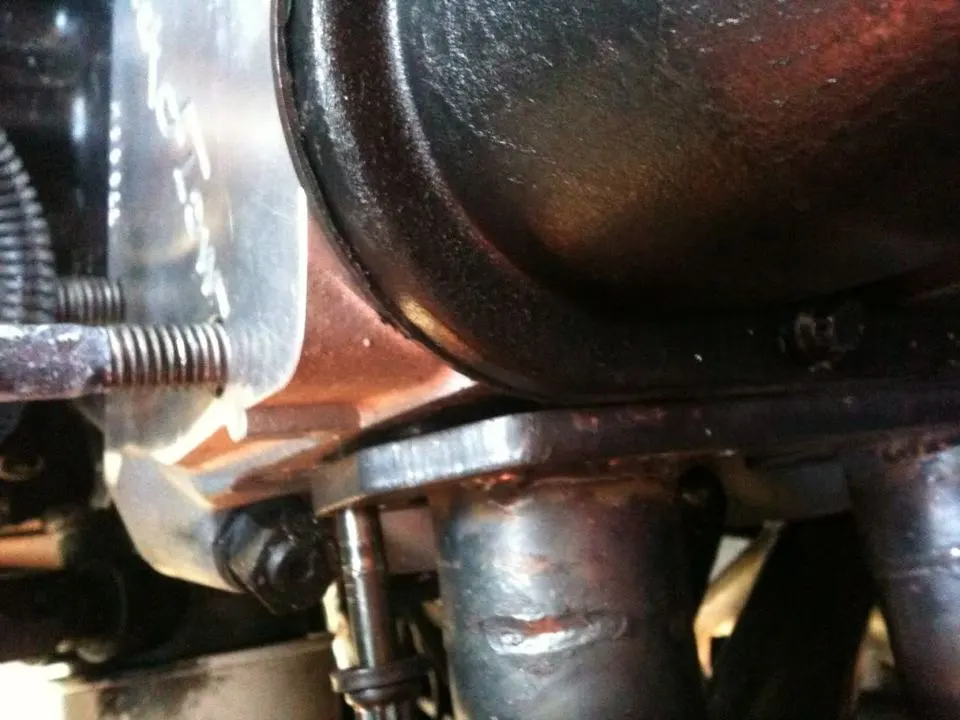

Things have gone from semi crappy and annoying to serious failure. I decided to work on the drivers side b/c it seemed to be much easier. I unbolted the steering shaft and w/ out even having to raise the engine or the car higher then it was the went right up in. I was starting to feel a lot better about all of this at that time. They seemed to clear everything pretty well so I decided to connect the steering shaft back up just to be sure eveything was all set. I got it to go through the space between the tubes but once the shaft was connected the headers would no longer sit flush with the heads. One of the tubes was hitting the knuckle on the steering shaft and slightly pushing the header enough so that it would not sit flat with the heads. Granted I am trying to do this by myself and its quite difficult but no matter how I maneuvered the header w/ the steering shaft connected it would just not sit flush w/ the head, with it disconnected it was fine. Here are a few pics I tried to get one of where the tube was hitting the knuckle but the oil level tube was kinda in the way. Needless to say I'm kind of at a loss now, WTF am I suppose to do now? I have a set of custom heads and headers but I cant get them to match up with eachother. I'm at the point of just selling the damn heads and getting a normal set of trick flow heads with normal exhaust ports and getting a set of 351 swap headers. I'm just so frustrated that I'm really not sure what my options are.

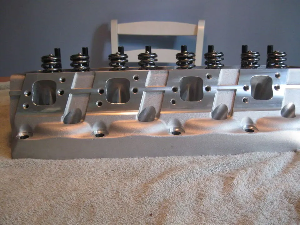

also to add insult to injury the header bolts I have dont fit the flanges on the headers. These heads have two sets of holes in them for headers to be bolted up. As you can see from the pick there are 4 bolt holes for each port ( 2 on each side of each port) the header flange has holes in it that match up with the holes on the bottom left of the exhaust port and the upper right in a diagonal pattern. The ARP head studs I have screw into the heads in those holes but they do not fit through the holes in the flange on the headers.
Jesus, they have the tubes going around the steering shaft. That setup is always a pain in the ass. The old Mac headers used to be like that, and you had to put the primaries in a vice to flatten them to make the work. Call the guy who made the headers and see if a Flaming River steering shaft is required. It's narrower, and I know some of the headers require them. I'm not quite sure what you are saying about the ARP studs. It looks like a bolt you have in there in the picture. I'm not sure what you having going on there. Are the studs too thick, or are the holes mis aligned? It's just a standard 3/8"-16 bolt hole.

That is an intake stud that I had laying around just to hold the header in place so I could try and bolt the steering shaft back up w/ out them falling out of place. The studs are to thick to fit through the holes in the flanges. The intake stud fits through the flange but the header stud would not.

Welcome to the club. This is so typical of aftermarket parts. If the ARP studs don't fit, I wouldn't use them. I just don't think it's worth the effort of drilling all those bolt holes out. I'd honestly go for a locking set of bolts given how unbelievably tough it is to get those headers in. Do you really want to go back later on and change a gasket if a nut comes lose on those studs?

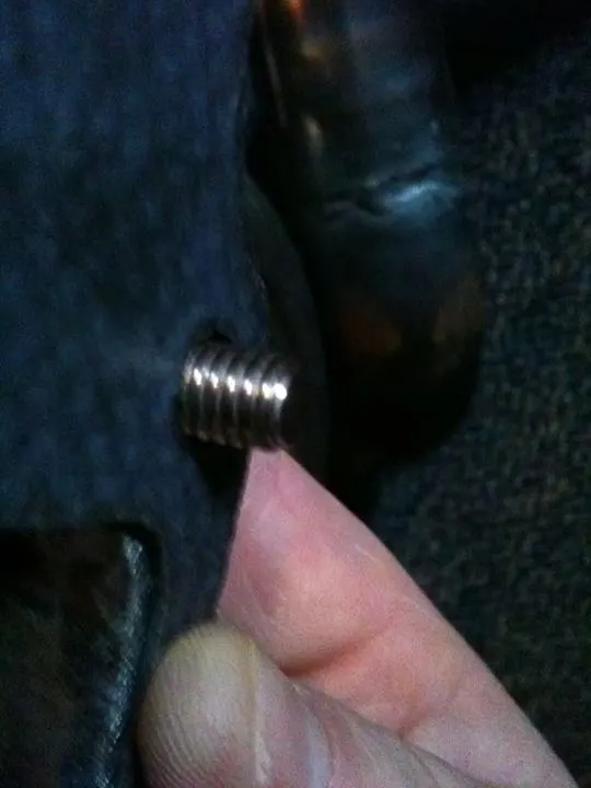

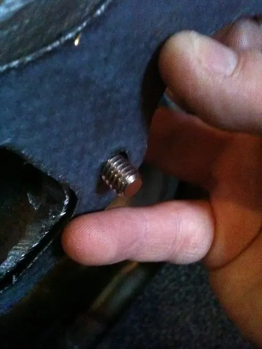

well I got the correct size bolts today from the big brown truck. There are 14 bolts in the package (which is full) but I need 16 bolts lol. Oh the joys of a custom set up.... These bolt's are the size for a Chrysler (5/16) not the standard ford 3/8 for header bolts so apparently a Chrysler only needs 14 bolts. I'm going to call ARP later today and see what I can do about getting 2 more additional bolts.
I took a few pics b/c I wanted to be sure if there is an adequate amount of threads left to thread into the head to properly secure the headers.
