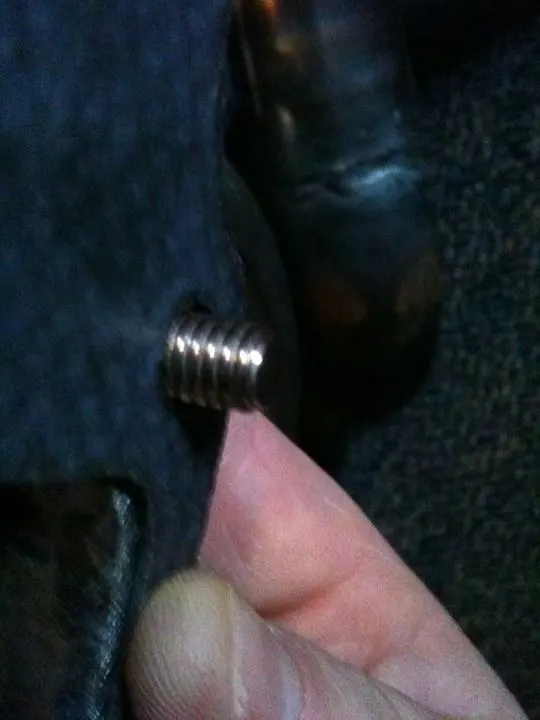

well I got the correct size bolts today from the big brown truck. There are 14 bolts in the package (which is full) but I need 16 bolts lol. Oh the joys of a custom set up.... These bolt's are the size for a Chrysler (5/16) not the standard ford 3/8 for header bolts so apparently a Chrysler only needs 14 bolts. I'm going to call ARP later today and see what I can do about getting 2 more additional bolts.
I took a few pics b/c I wanted to be sure if there is an adequate amount of threads left to thread into the head to properly secure the headers.
It looks ok, but aluminum is soft. Ideally you need 1-1/2 times the thread diameter for length of engagement. I wouldn't trust it at any less than 1 times the diameter in a pinch.

The header flange is thick that's why I was wondering if there was an adequate amount of thread left. I thought the bolts were going to have more sticking through the flange. So is this like an on the fence thing where they might be ok or might not? They are .750 in length, should I just keep them b/c it is fine or send them back and get 1" bolts.
what does the -18 or -16 mean when it comes to bolt sizes? These are 5/16 -18 bolts. There are ones that are -16 that are an inch long but I got exactly what I was told that the bolt sizes were thats how I ended up with 14 bolts and ones that were .750"
I could swap them out with these.

18 is how many threads per inch... (that is a course thread, a 24 would be a fine thread when your talking 5/16" bolts)
You can't go wrong with longer bolts if you have the depth, some aftermarket alum heads for a Ford will not take a 1" long header bolt. (stock bolts are 1" long) so most guys buy 3/4" length....assuming a standard header flange thickness

These header flanges are pretty thick, I threaded the .750 bolt all the way into the head. With that being said a 1" bolt should work considering there is the thickness of the header flange that will take up room. I would rather keep these then to send them back and reorder another set for the second time but that's only if its recommended that I should. If the bolts I have now are fine then great but I don't want to keep them if its right on the edge of maybe so so being ok

Well, simply because they are 5/16" bolts means they won't work. You need 3/8"-16 bolts for Ford heads. I run 3/4" bolts with similiar thread depth on the backside. Before you commit to a 1" bolt, screw another bolt all the way into the head, and measure how much thread you have coming out the back. Having a bolt that is a little on the short side is better than having one that is too long. Some of those aluminum heads do not have much thread depth in those bolt holes. If the bolt bottoms out in the holes, you will never get them tight, or worse, you will break the head off the bolt trying to get them tight. Those bolts don't have to be that tight on an N/A car. The key is even pressure, and make sure they don't back out. Threads are much more likely to get messed up from cross threading, or removing the header too many times an retorquing. I know I haven't posted in this thread in awhile, but I was stuck at work while the airline was trying to conduct a sleep deprivation experiment on me. I just slept for 10 and a half hours.

Well I have the 5/16 bolts now I'm just trying to find out if t should get the 1" bolts or keep the .750" depending on if I have an adequate amount of threads to go into the heads as you can see in the pics I posted.

Venom351R said:
Well I have the 5/16 bolts now I'm just trying to find out if t should get the 1" bolts or keep the .750" depending on if I have an adequate amount of threads to go into the heads...
Just stick a small screwdriver into the bolt hole, measure how deep it is. Measure the thickness of your header flange. Add the 2 together and see if a 1" will work. Easy peasy, man.

I already threaded the 5/16 bolt all the way into the head, add that length + the flange and a 1" bolt will fit. I know it will fit its just a matter of if I SHOULD and if I NEED to go to a 1" bolt. What I mean by the adequate amount of threads is if there are enough threads to properly secure the headers with the 5/16 bolt as from the picture or if 1" bolt is better suited.
