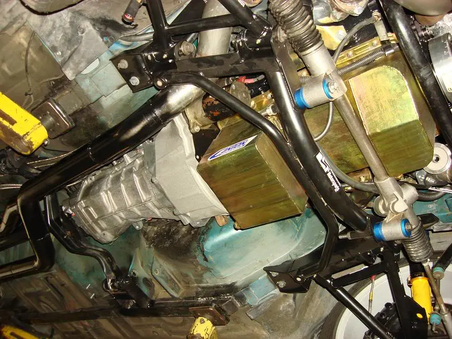

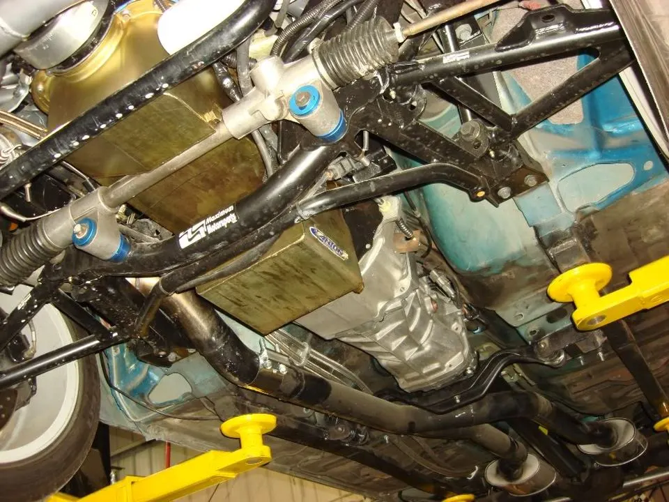

Below is my car. In waiting, I also have battle boxes, stiffer rear springs, and MM adj rear control arms. But, this winter has been so snowy and cold, I'm not going to have time to put them in during this winter like I planned. Oh well, there's always next winter's down time.
