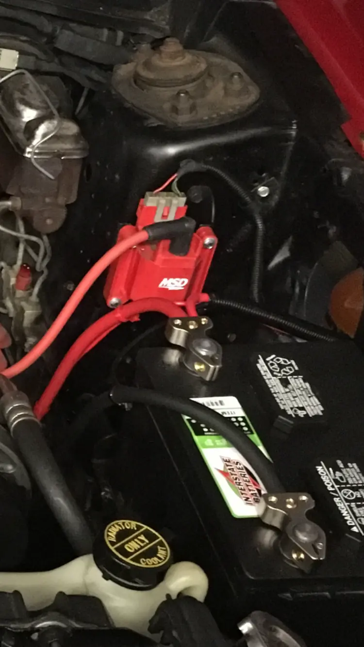

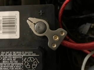

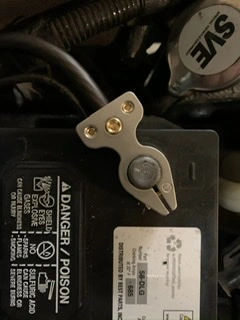

However....... these are the best terminals I’ve had on anything, by far. PA Performance
Did you crimp a ferrule over the wire? Most mechanical connections (set screw) are not designed for the fine wire used in automotive applications. So a ferrule lug is crimped on first to hold the strands in place and make the connection resistant to vibration.
You must be an engineer, I wouldn't of thought of that.:jester:
Nope. Makes perfect sense, but right now, the set screws are just down on the stranded wire.

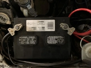

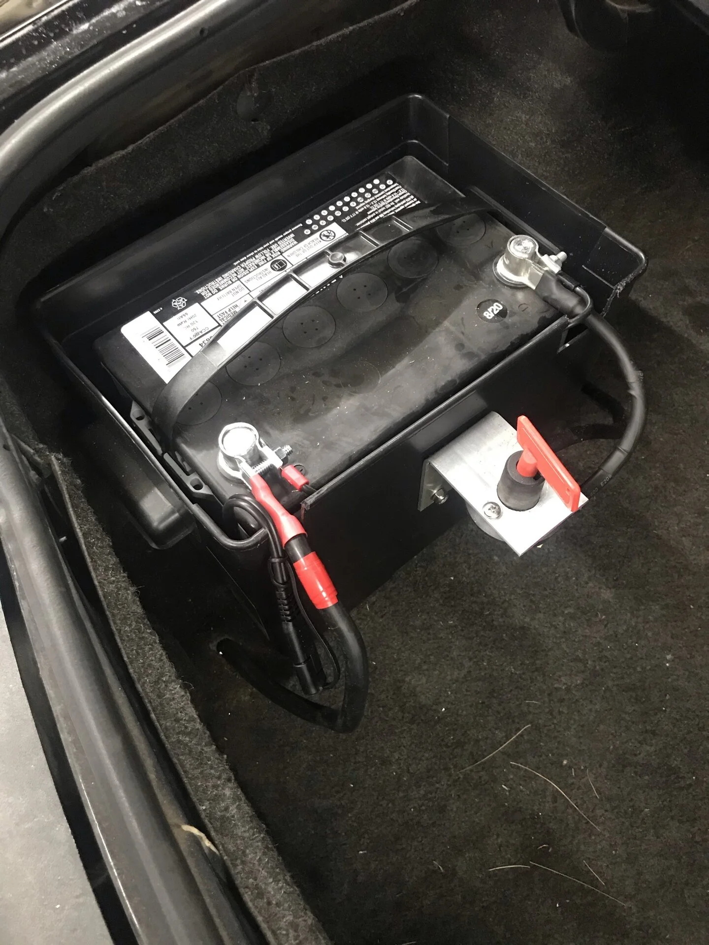

I like the lead free factory style like this:
They don't look very fancy but they work well. Rest of the setup is a marine battery box from o’reilly and a shut off switch from harbor freight. It was very cheap and works well. I know you probably won’t be able to use a setup like this because your battery is in the engine bay, but wanted to show what terminal I’ve found work best for me.
The terminals @Rdub6 is using look nice.
These look clean and simple when new. Steel does not stand up to battery acid at all compared to ugly old lead ends. Please use the anticorrosion spray for a better service life. If not, I have seen them fall apart after almost dissolving and strand non Motörhead’s.
