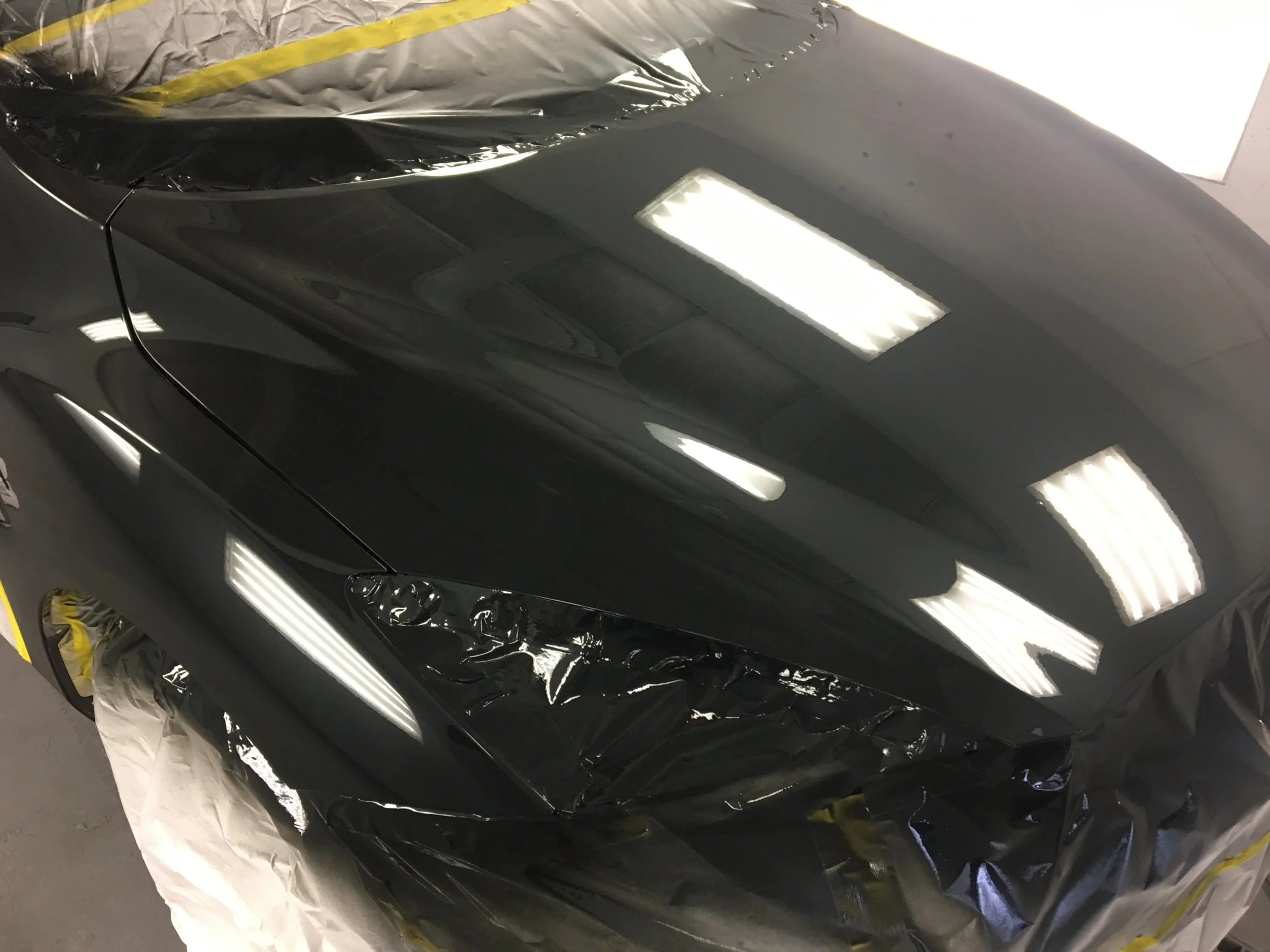

Here's a picture of a Mazda 3 I just painted the hood, fender and front bumper on. This is an average Sikkens paint job.
It's kind of hard to show how flat the clear lays out, you just have to trust me, it's very nice.
