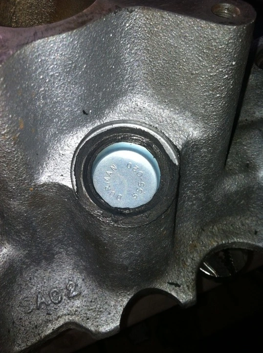

1.125" freeze plug sealed with rtv
No more PCV with a vac cap
Doorman part number 555-020

Im guessing you would need a breather or 2 in the valve covers tho no?

Yea def need a breather or 2

What about the line on the throttle body, just cap it off?

The only advantage I see is that that stupid vacuum line won't pop off haha.

I run a vac cap on the tube on valve cover. Have the throttle body filled and smoothed where the hole was. Reason I did it is to keep oil out of the intake track.
