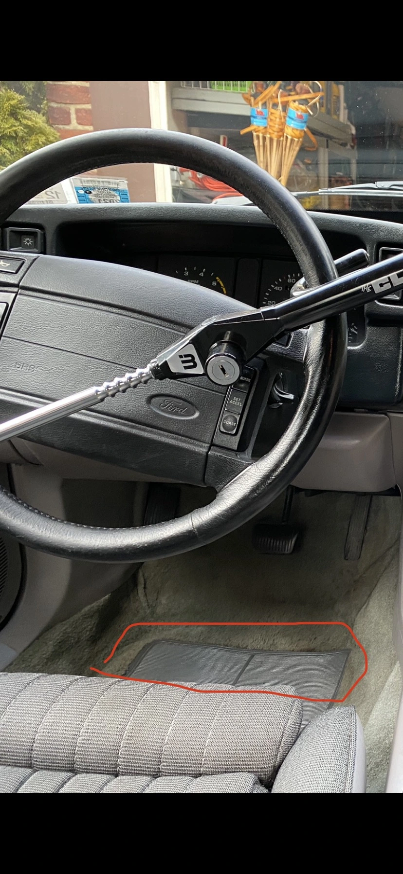

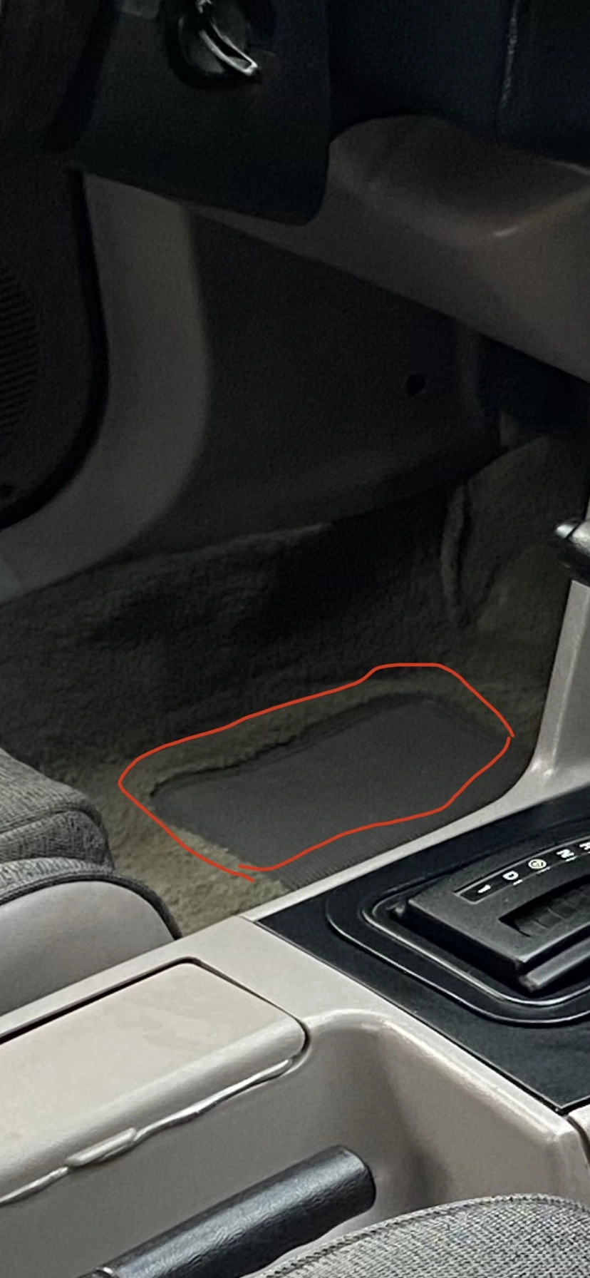

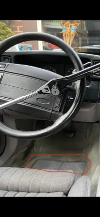

So it gets wet directly under the floor mat. On the area where the rubber mat is built into the carpet. It gets a little damp, not really wet at all. Just damp to the touch of fingers. Under the floor mat would be some condensation. Doesn’t happen anywhere else. Strange because the floor isn’t rusted and the carpet around that built in rubber area isn’t wet. Just slight dampness on the edges of the carpet around the rubber part and condensation on the rubber itself. So the car has a tarp over the cowel vent and windshield, a water proof cover over it, hasn’t been driven and a floor mat on the carpet with no rust on the floor but yet still gets damp. Weird.I outlined it in red where it gets damp.

Hummmm, ok maybe this is it! I bought the car in December so I can’t say if it’s a new or old
Problem but I just discovered it myself a few weeks ago when I bought new floor mats. The mats were in the car for a week or so and when I went to shamooo the carpet I took the mats out and discovered the bottom of the drivers side was a little wet and the rubber part built into the carpet was slightly damp and the perimeter around it. I have been checking it every few days since then and it’s always the same. The days have been very cold around here so when i check it’s always cold to the touch which makes it feel more wet but it’s actually just a little damp. So now you have me thinking maybe it’s been damp since I bought it 9 weeks ago and never noticed because I’m still looking around and learning the car. In other words I don’t know this car and it’s history upside and down yet.

From your pics the car looks pretty clean. I apogee for the kinda sharp remarks earlier. Some people come in with some rough stuff and there's no way of knowing without a pic. I think that's some old moisture just hanging around. Hopefully when it warms up you can get us some more pics of that beauty.
