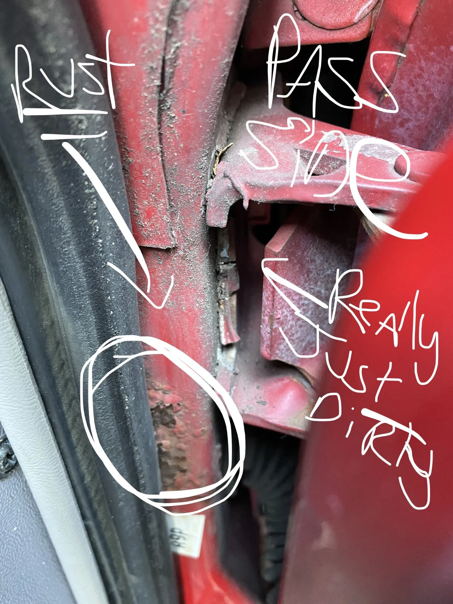

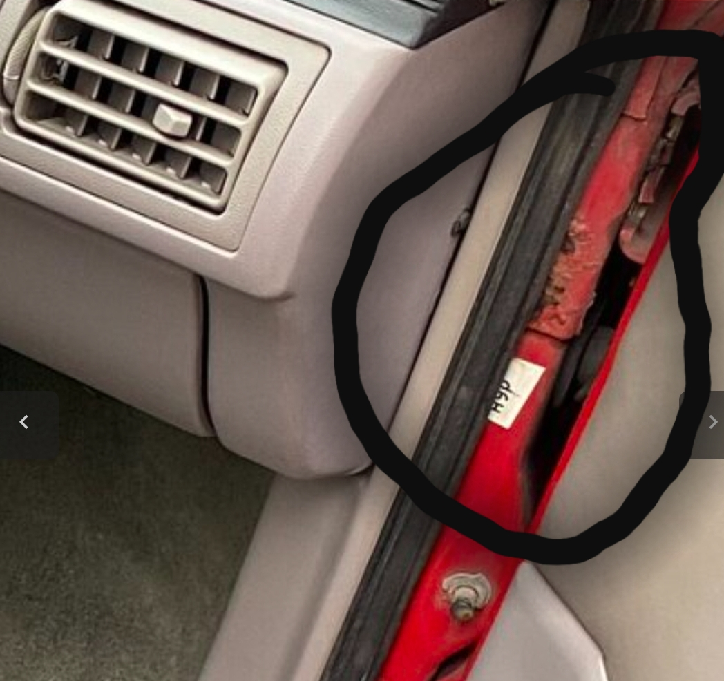

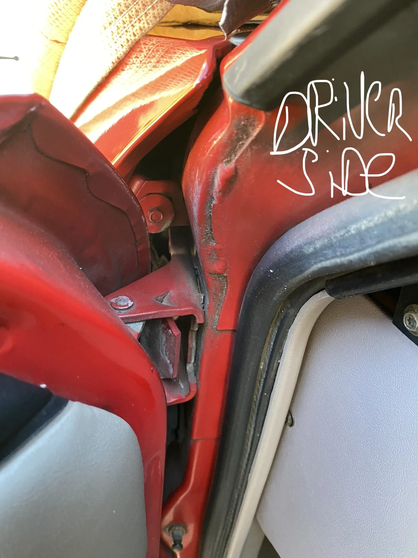

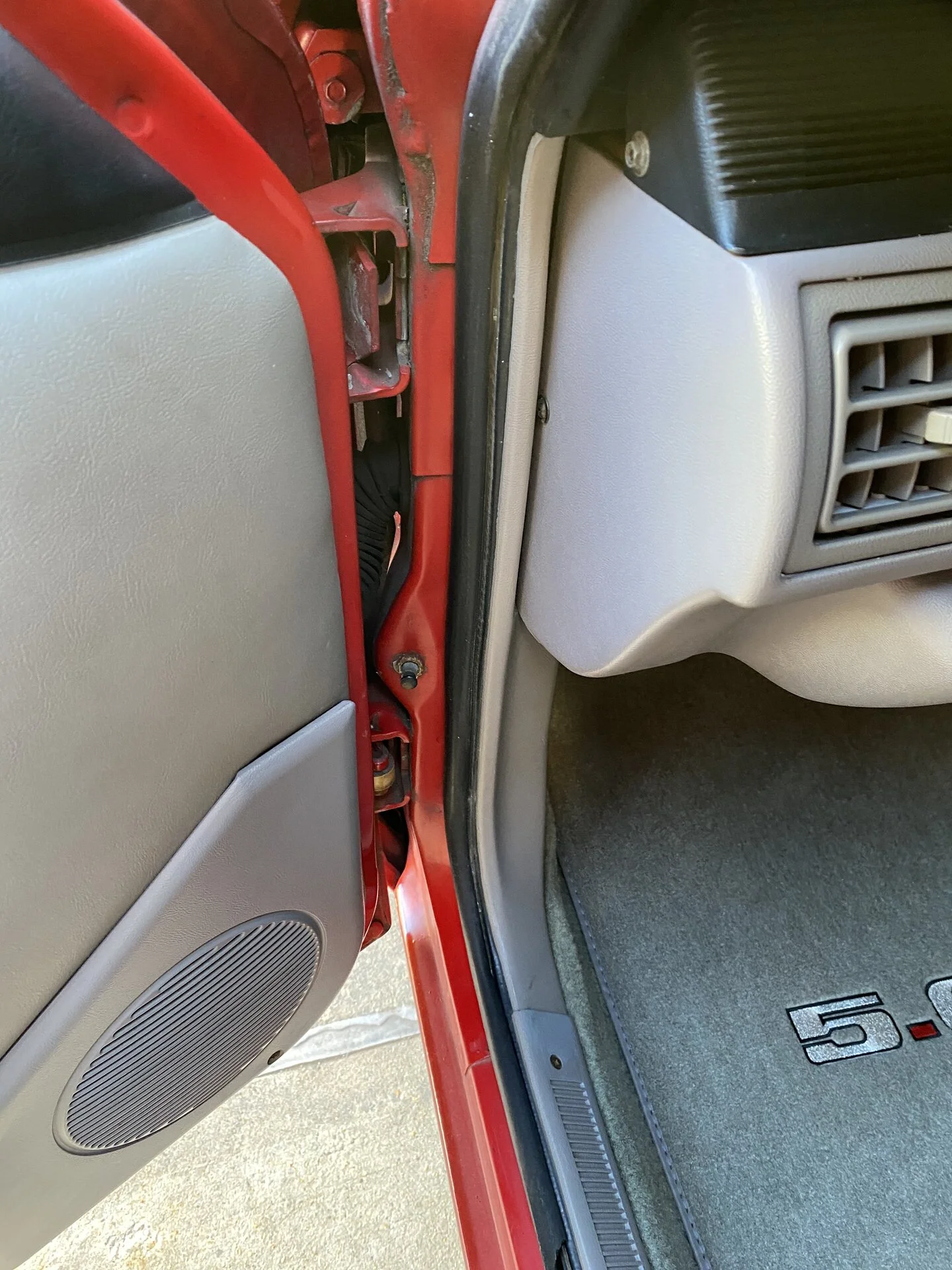

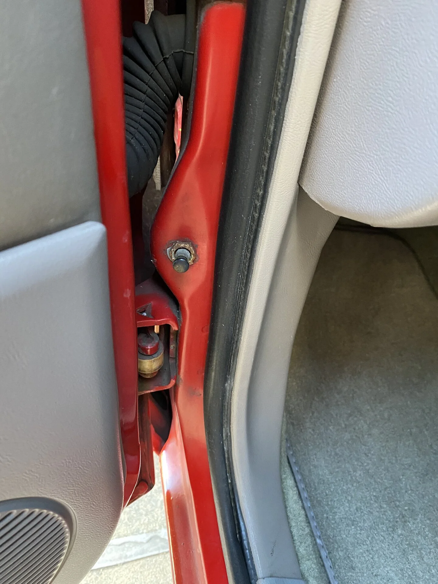

Hi. Me again. I am NOT trying to be a downer here but I looked at the pictures in your other post and I see something concerning. I see rust on you passengers side in a very common fox rust area. Usually if there is rust here, there is more that is hidden under the fenders. You really need to at a minimum get a scope camera and look up inside this area and see what's going on. I would like to see pictires of the drivers side in the same area if you can.
Hey good morning and welcome back! Lol I didn’t notice this so thanks for pointing this out! No worries about being a downer. I am always glad to be told what’s a problem so that I can fix it or if not at least I’m aware of it. Good eye! Ok so attached are pics of the driver side. I’m no expert but to me, thank goodness it looks clean of rust. Just a little dirty but I don’t see any major or small rust. The passanger side I’m gonna have to look at more closely. I have a camera video scope so I will do behind the fender on both sides. Thanks for this info!

That rust spot on the passenger side needs attention and does raise the question of more rust in the cowl area. That inspection camera will be useful there.
I had my 89 convertible stripped down ( fenders, hood, and engine pulled ) for rust repair in the strut tower area. I had a work light sitting on the passenger floor. When it got dark I was walking around the car and noticed a glimmer of light through the body structure that welds to the cowl. My heart dropped as I gazed through and saw stress cracks all over that corner. Not rust in my case but cracks that ran all the way into my car. From inside the car I could see them through a gap where the harness runs to go in the engine bay. In all the years I owned that car I had no idea. That car was raced and driven hard. Not sure if they were there when the 10 point cage went in. Clean and inspect the cowl and hinge area thoroughly as soon as you get a chance. Helps to pull the fenders off so you can clean out the water channels.
I didn't even notice that spot in the passenger side. He's got a good eye for sure.
