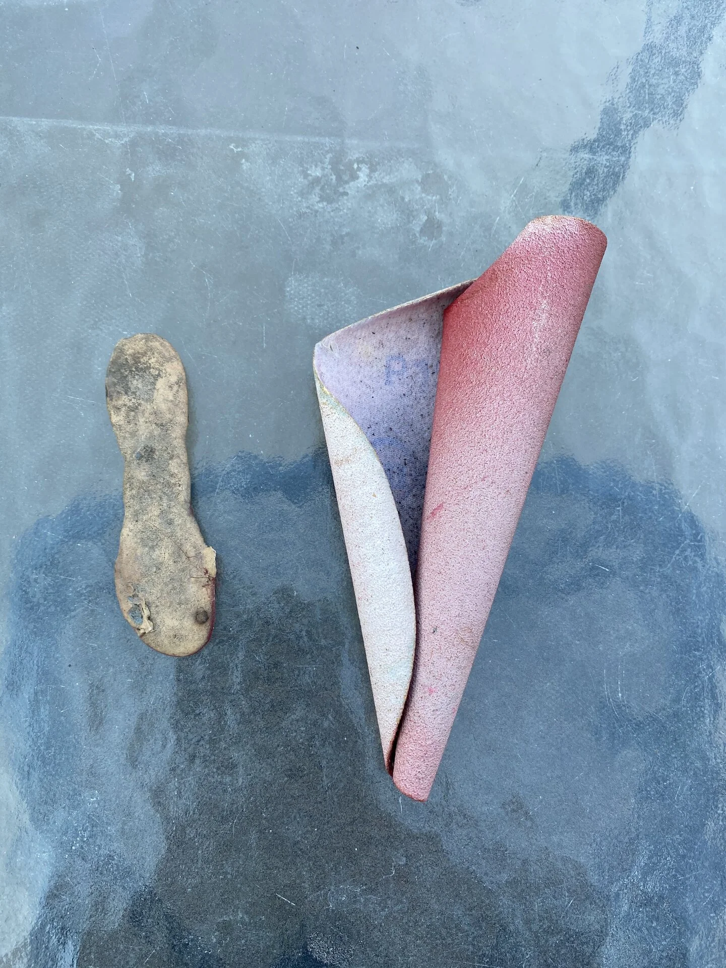

So today was the first warm beautiful day in NY in a very long time so I took advantage and went out to the driveway and tore things apart a bit in an effort to solve this problem taking into account all the advice and ideas that were given. I won’t know for sure until we have some rainy days but going by today’s findings and replacement work I’m confident it’s solved.
I pulled up the carpet, wiped and dried as suggested to me. It was a tiny bit damp but nothing major and no rust. Left over moisture it seems. I pulled the kick panel as suggested. Nice and dry! I replaced all the weather stripping both side doors and the hatch. The doors were all chewed up but now nice and fresh. I pulled the cowling and took a look inside. No rust. However, see the pictures attached. OMG! A piece of sandpaper was stuck in there as well as some hard unidentifiable object! Wtf! Left over from the paint job before I bought it. I also sanded the rust spot on the passanger side door frame and coated it with rustoleum then some color to protect in the future. The rust didnt punch through so I was happy about that. I also took a peek behind the fenders with the scope and they were clean of rust.

pic is what was in my cowling pushed all the way to the driver side underneath and halfway over the hole (or drain or whatever that is. Lol)

That hard mess looks like old factory seam sealer. Glad you didn't find a disaster under there.
Update: it rained all day yesterday and during the evening. I just checked and she’s 100% dry! Problem seems to be solved. Thanks for everyone’s suggestions and ideas. I post this update for those who may have the same problem so they can see what worked for me as maybe it will for you.
Checking the cowling to find a piece of sandpaper stuck in there as well as some other foreign substance and changing all the door and firewall weather stripping worked. I also pulled the carpet and used towels and a blow dryer to do away with the moisture that was previously there. Today for the first time she was 100% dry! Thanks guys!
