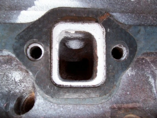

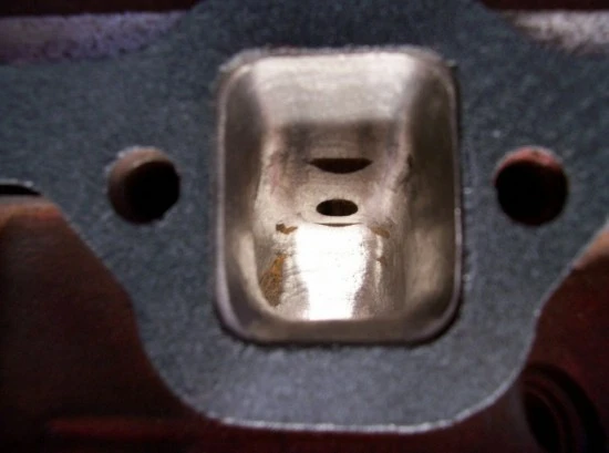

Thanks for the link! He says, among other things:
"Removing the thermactor boss did raise the high lift numbers about 1 -2 cfm, after porting, but then leveling the lateral roll near the exit roof, lowered them again a couple CFM."
This is for E7TE, which have a MUCH smaller "smog bumps". He cautions that on E7TE heads that the exhaust ports are very sensitive to small changes, and he got a lot of negative results on the exhaust side.
Very informative for these heads - he shows photos with the air injection boss completely removed, leveled off at the roof of the port. My question is, on a D4 head if I completely remove the bumps, will I run into any structural issues?
Remove ALL of it.. yes this is a pix of the E7's cause those are the heads I do... but cut it all out and make a straight shot back into the bowl!! floe is on the top of the port!! cool??
