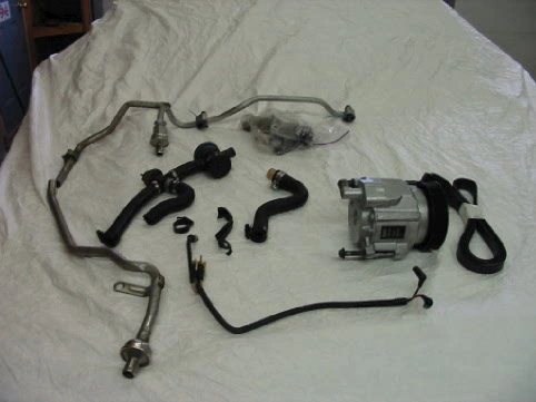

If you do the EGR dump....remember to "set" the plunger on the electrical unit that comes off the EGR....disaasy it from the valve, couple screws, set the plunger to midway and secure it....otherwise you WILL get a CE light...
block off you tube on the header..
make a b-off plate to cover where the EGR bolted to the intake...
what you see is whats coming off....i pulled my codes after removing all this stuff and had nada....so no real adverse affects for me...
Edit...wheres the pic???? shows an attachment??? Oh well....SN growing pains again...

red94fiveo said:
Rio- this plunger that your talking about isn't ringing a bell, could you go a little more in depth? Thanks.
you unbolt the EGR from the upper...theres an plug to undo...when you have the EGR out you'll see that Gray plastic unit where the plug went in...remove the 2-3 screws, pull the unit off the EGR....theres a plunger on the unit....push it 1/2 "in" and secure it, then plug it back into the connector...thats whats makes the CE light come on if left unplug or the plunger not set properly....you'll see when you remove it...
