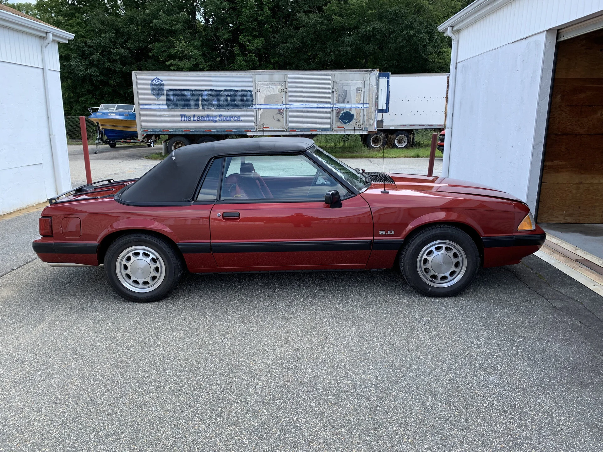

I have a 1990 LX convertible. I'm contemplating removing all the smog stuff. I have read the discussions on here as well as other articles. I really familiar with codes, abbreviations etc. The main thing I'm curious is once I remove everything is there anything I need to do like change electronics or make adjustments?
