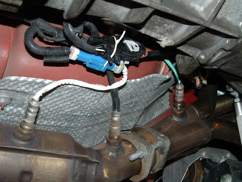

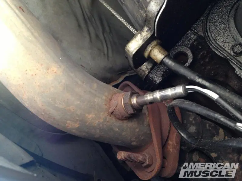

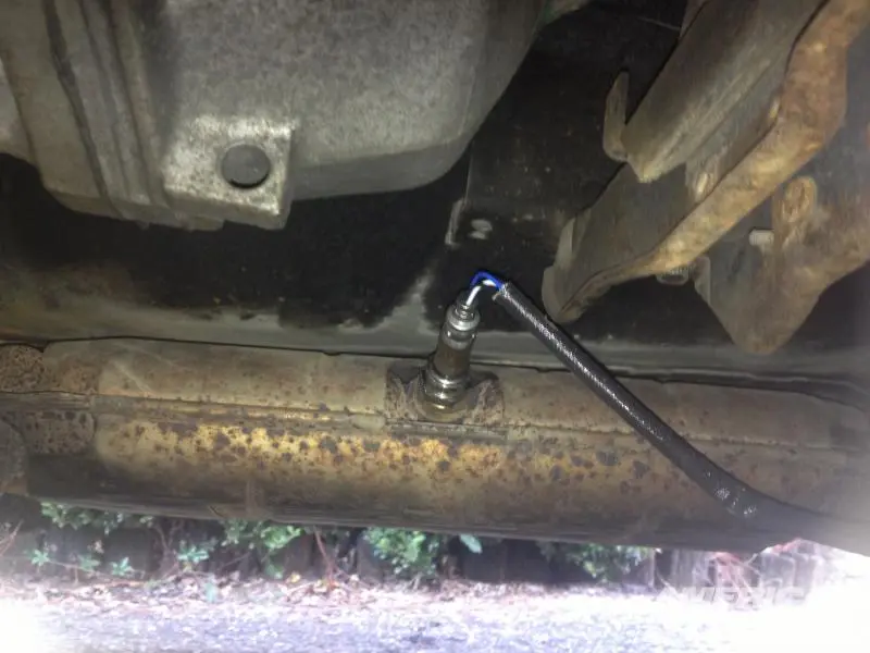

now back to engine so computer is spiting out codes 172 and 176 witch i think would mean i have to change the O2 sensors on both sides .. i have looked up 1994 mustang o2 sensors and they look like they would be very hard to get at with out having the car on a lift ... i have also ran into i have seen 3 different pics of 94 mustang o2 sensors
id like to try to see and make sure they are plugged in all the way first but have to tell buddy where to look
The first picture is the best representation of the driver's side O2 sensor.
A jack and jackstands is how most of us get to things under the car. Some SUV tall jackstands and a good floor jack will do the trick, Harbor Freight Tools has jackstands that often go on sale.
