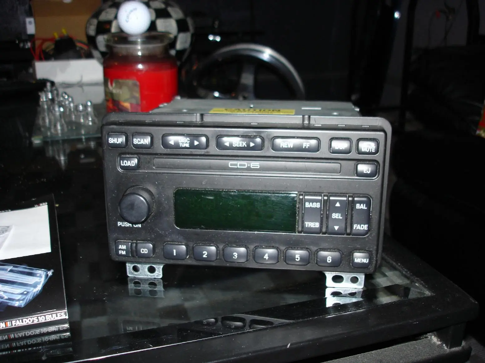

WHat can I do with this bad boy? It's a Mach 460, but i don't have the amps and other parts.
I guess my first question is can this unit be wired as a standalone head unit? :shrug:

ok, i am probably the the only authority here to make this work as i have it in my 93. I have one of these decks that i disected to find where Visteon installed the crossover to cut low frequency's to the internal amps power ouput. So far I can't locate it, and to say that Visteon is stingy with the component schematics is a gross understatement.
So the answer is no. you have to have an amp to power the midbass/lowend. BUT you dont need to use a ford amp to do this. I have a 6disc deck like mine in the wife's 90 fox in the stock location, wired into a cheap coustic 25wX4 amp and it sounds great.
Here is the diagram that I used to make my pigtail harness for the amp.
I have a 1" tweeter in the dash, a 6.5" Midbass driver in the doors, and a set of 6.5" coaxials in the rear deck on a 1/4" baffle board. front tweeters are running off of the deck and the rest off of the small amp.

I already have a 4-channel amp handy, so i could do this. All i need to do if cut myself some radio harness plugs for the head unit out of a junkyard car so I can splice into it.

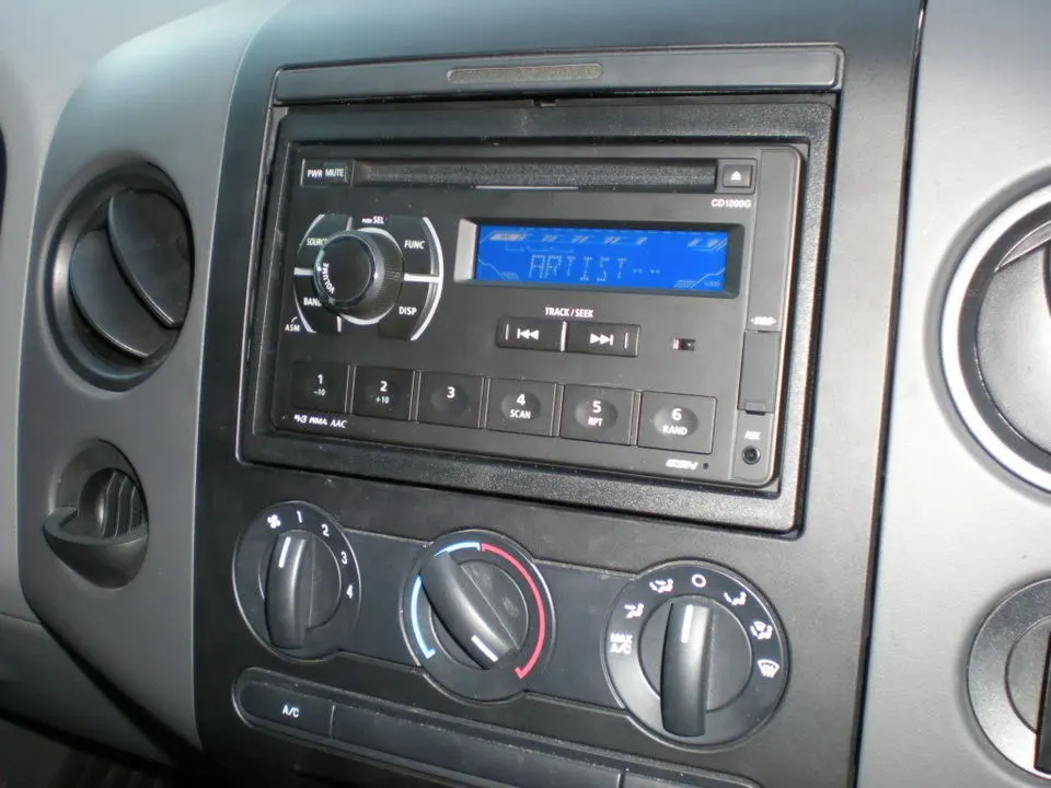

I get wanting the stock look but I have never come across a stock radio that sounded good...which I suppose is not your concern here but just seems like wasted effort IMO. I would be curious to see a picture of how that unit looks in a fox. Also, you can find plenty of aftermarket radios that look clean and aren't all flashy on the cheap and the sound quality is far and beyond what stock junk can produce.
That does look pretty stock.
But at this point, i just want to see if i can make what I have work. I have the head unit, i have a 4-channel amp, i have wiring and RCA's. I even have 6 speakers i can use in my fox. This is very low cost.
The only thing i need is to go grab some wiring pigtails for the back of the 460 so i can splice wiring to. Considering there's 2 feet of snow outside, i have no idea when ill head to a junkyard to snip some out.
I guess i can order the double din Metra kit and see how this would even look first.
