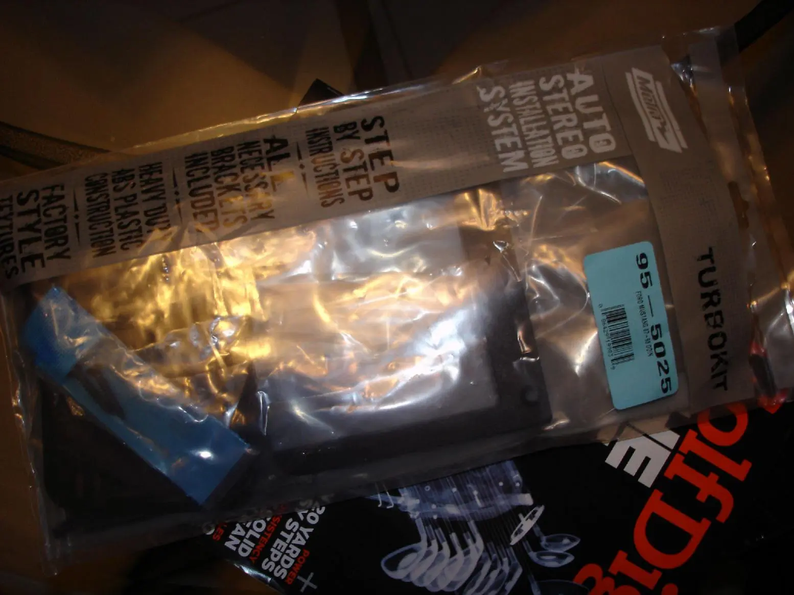

Metra 95-5025 kit came in.

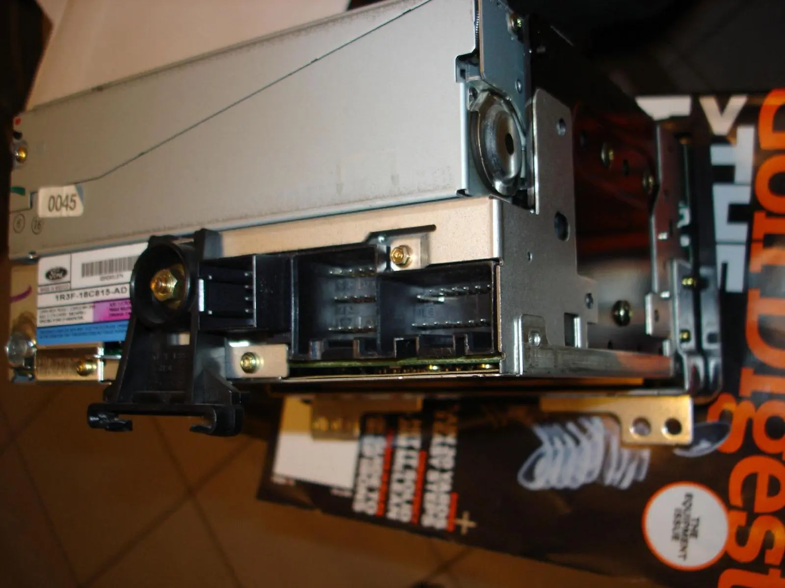

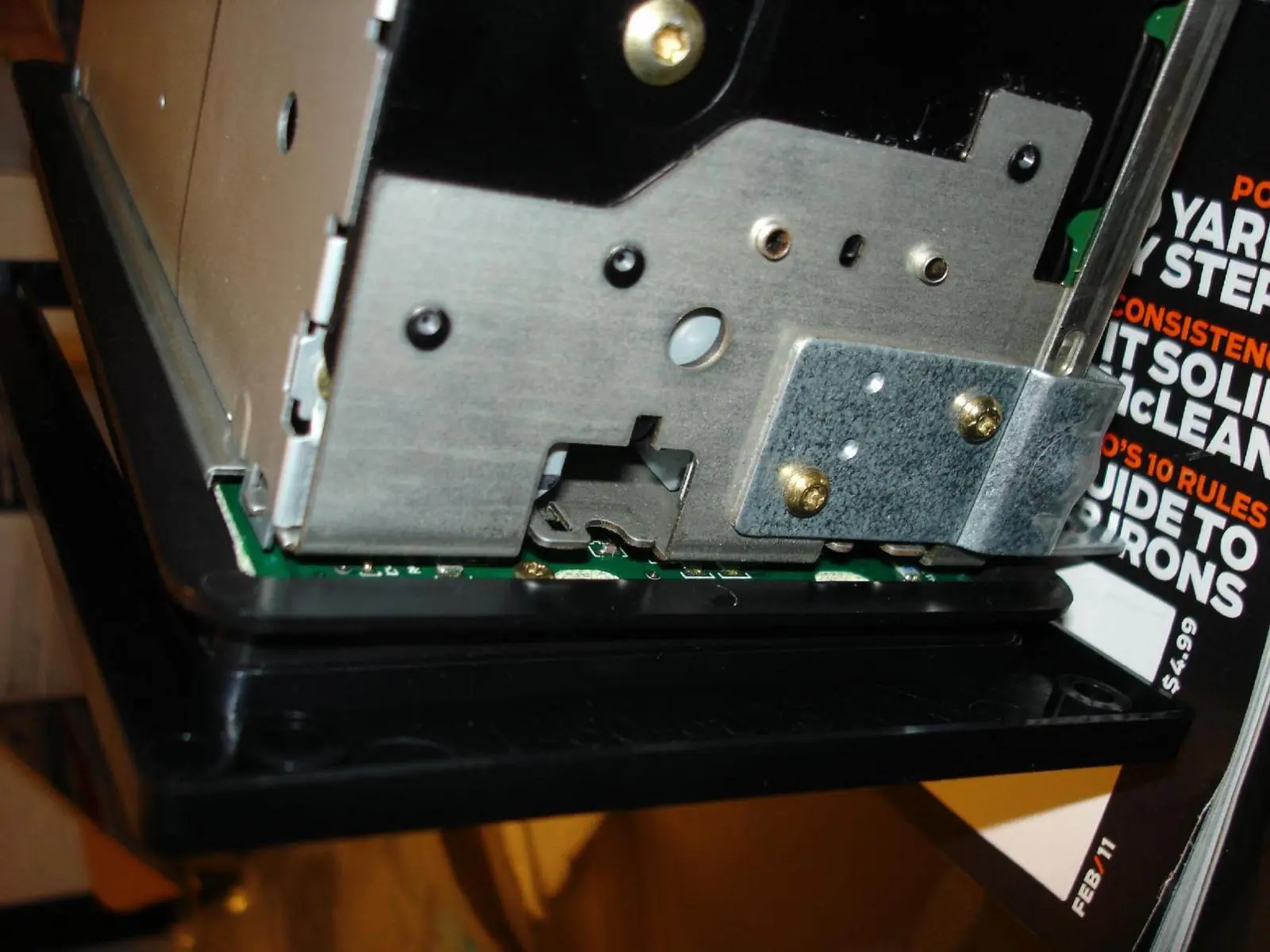

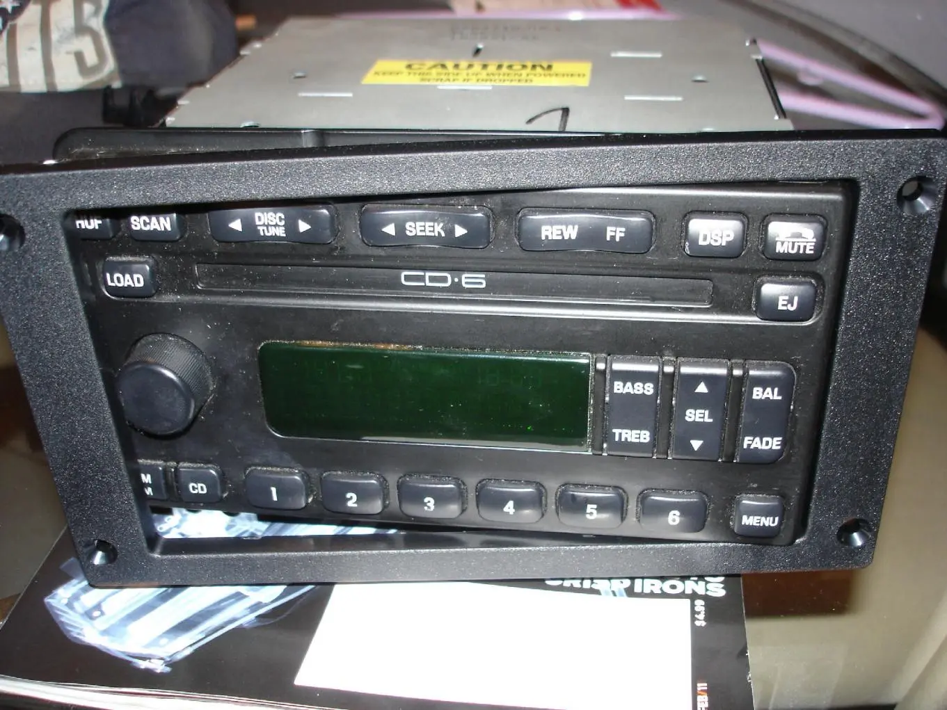

Can already see an issue. The slot is not wide enough. The height is correct, but i need to open up the space with a dremel.
attachment.php
When i trim the opening a little, it's going to take the face of the headunit right to the screw holes. It might not be a bad thing though, as there is a little lip that runs all around the radio. It might seat against the console's opening and the metra kit will sandwich it in place leaving a solid mount...i hope.

Also, you can see the two mount brackets that need to be removed. They come off easily.
