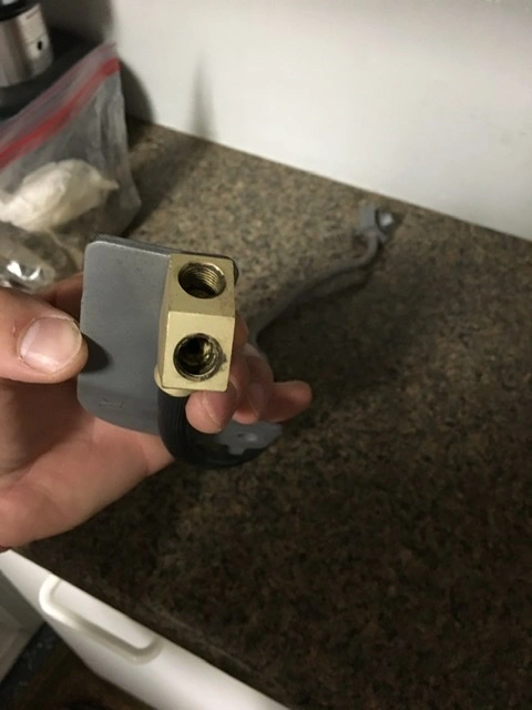

Can someone please tell me the purpose of this dual outlet transfer block of a 99 GT. Does it receive the main line? Or does it go somewhere else? Any info would be greatly appreciated. Thanks

I believe the split rear line is on the NON-ABS models. A single line travels to the rear of the car, and then one line jumps from one side to the other.
if I remember correctly, this line is on the right (pass) side of the car.
ABS models would have two separate lines to the rear from the ABS module
