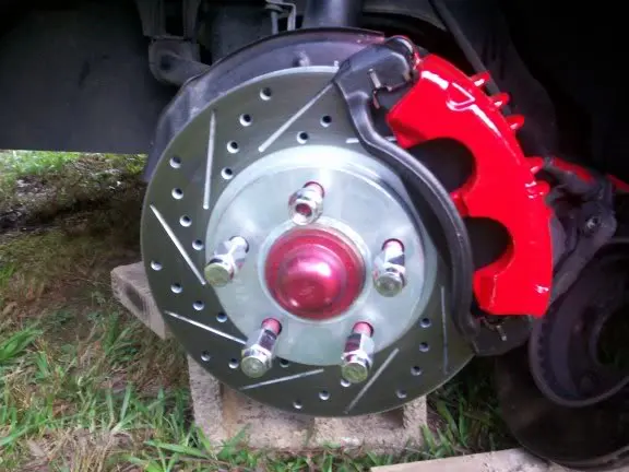

did it a few weeks ago...but mine is a 95 stang.read info. below picture..
the old lines there talking about are the rubber lines off the 94-95 mustangs. but to install the pbr's on your stang you can purchase a set of 94-95 rubber brake lines from a local auto parts store for about $27 (there $12.99 each here) and use the pbr banjo bolts you will also need to grind about 2/16 of an inch off the passenger side rubber line metal connector that the banjo bolt mounts thru you will see this when you go to install its easy to do also you will need one of these adapters in this link to connect the rubber line to your steel line on the passenger side http://cgi.ebay.com/ebaymotors/Must...ryZ33563QQssPageNameZWD1VQQrdZ1QQcmdZViewItem the drivers side rubber line should connect with no problems but you can verify this with http://www.maximummotorsports.com/ they are very knowledgeable about this subject they helped me with my install.
