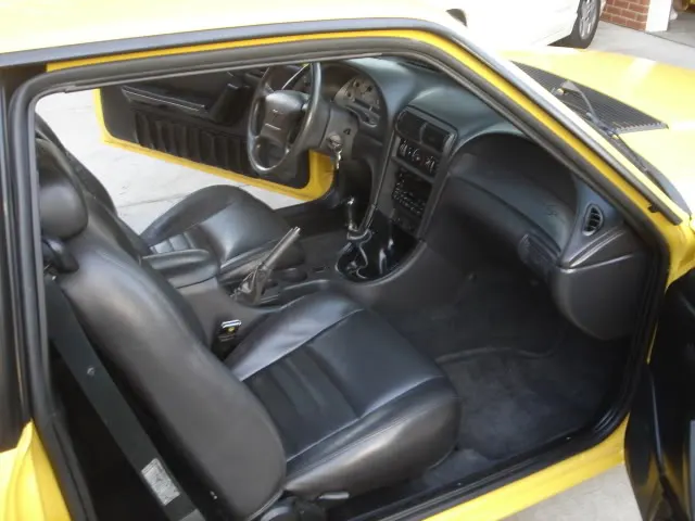

I have used 94-04 style carpets in two foxes now. Once all your trim is in it will look great.

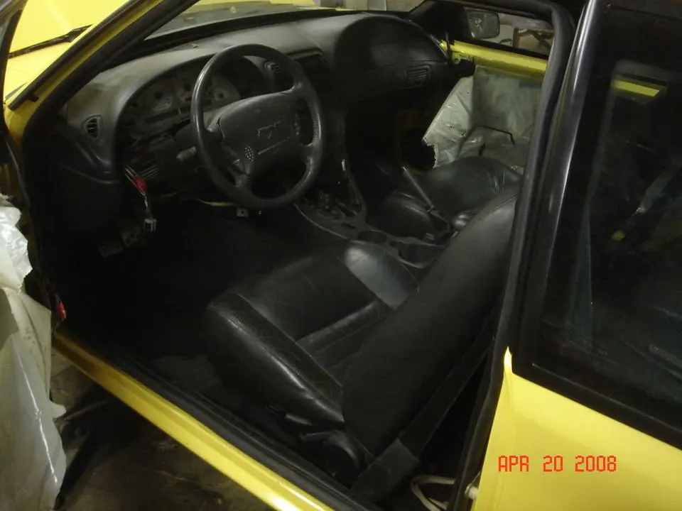

Hack Job
Here is a during the install pic. See where the sill plates are out? Crappy pics I know, but it's not like I took this for you...lol...this is old.

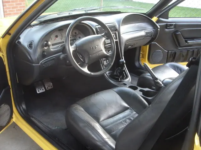

I got carpet from a 99 and my only issue is that it doesn't seem to come up as high under the pedals. Only an issue for me as that's where I ran some additional wiring. Moved it over the steering column and it doesn't look as bad now.
