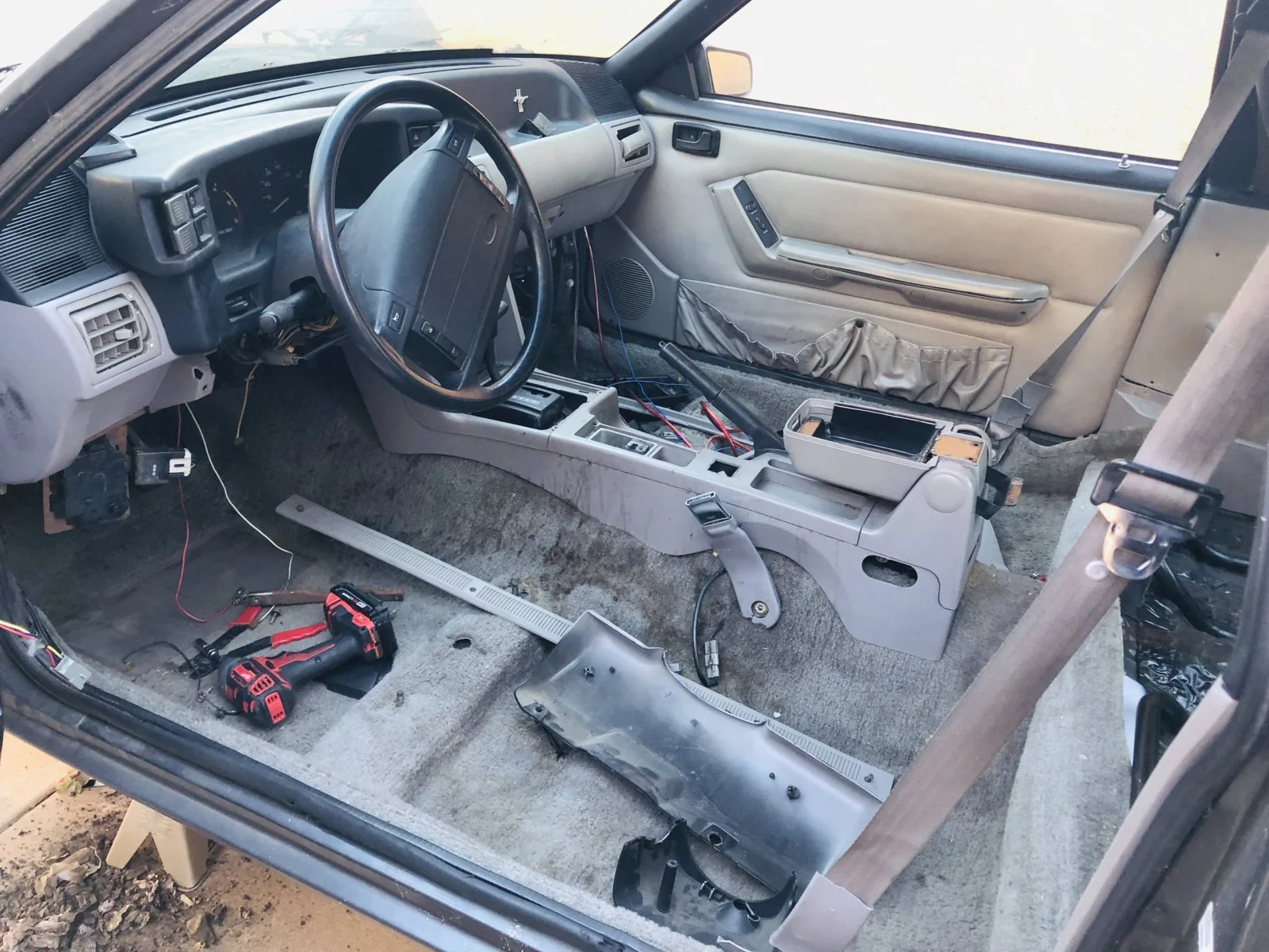

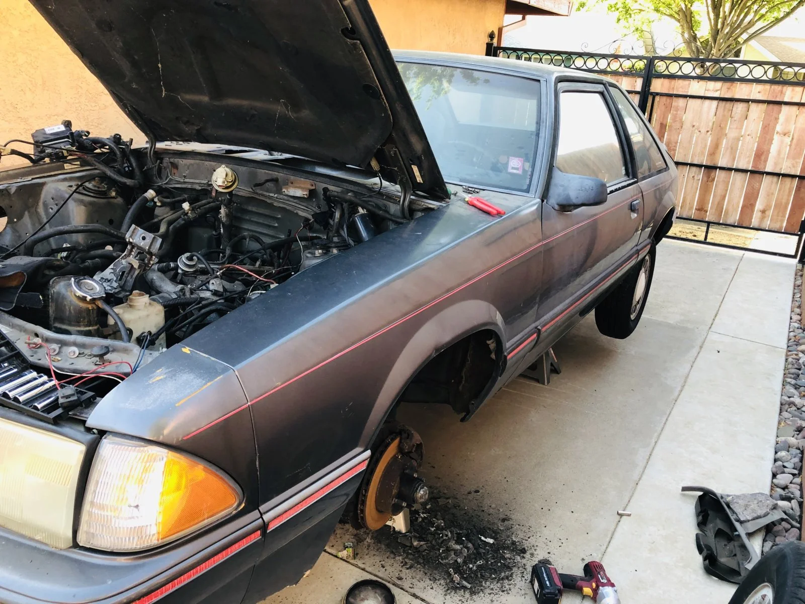

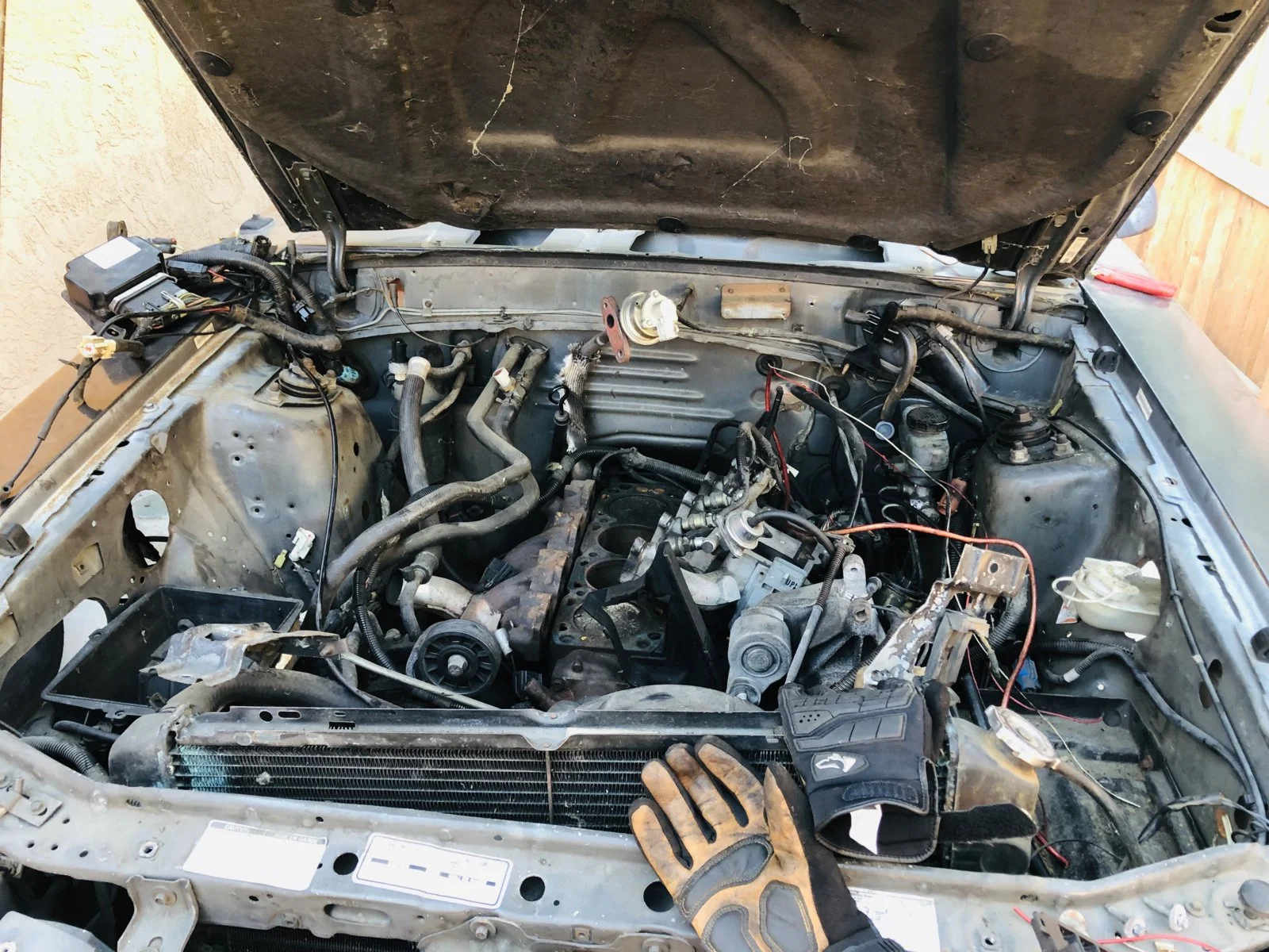

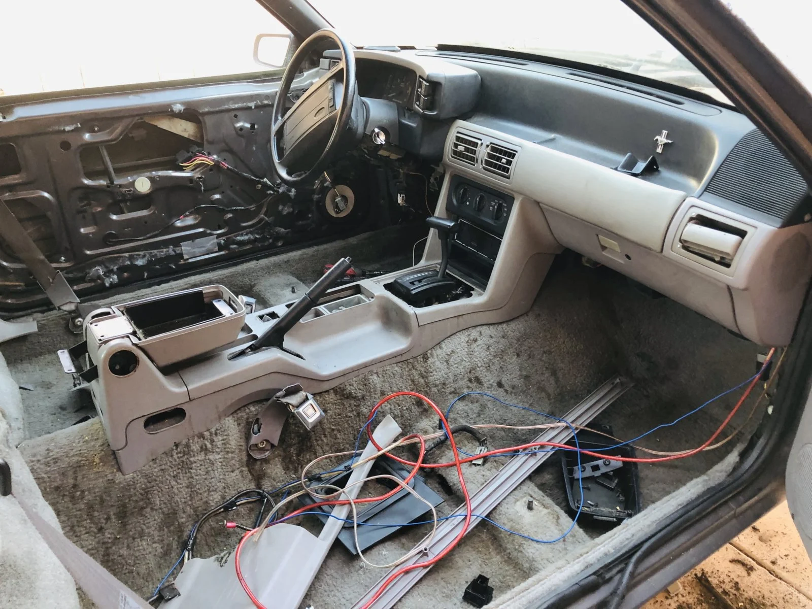

Slowly but surely I’m getting the foxbody stripped. The 1996 hasn’t been delivered yet, kinda bummed about that but while that’s not here I continue on the Fox
