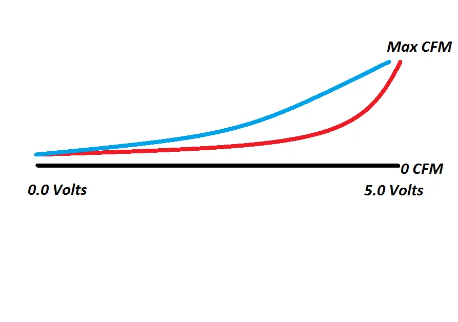

Why is only the 94-95 3.8 maf a direct swap? Whats different from the other 3.8 sn95s?
The transfer function of the meter itself.
I drew this quickly to illustrate a point:
The blue and red lines are transfer functions for two different meters. You should be able to imagine what might happen if your EEC expected the Red line but got the blue line instead.
Your air fuel ratio would be exactly wrong, all the way through it's usable range.

When I first saw your post on my phone I couldnt see the picture but now I understand it. Thanks
