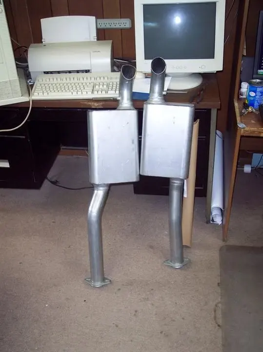

My car with mac dumps
My dumps when I bought them used. Little carbon build up on them. I love dumps on 94-98 cars. The look without tail pipes is clean.
