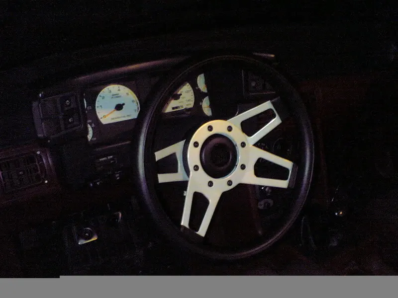

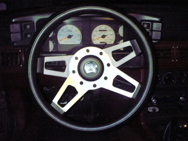

lookin tits dude! i'm gonna head to pick a part tomorrow to get these black quarter panel pieces i saw today but didn't ahve time to grab
okay makes sense. i dont need the power at all and i can cover the hole in the front with something. actually want the seats to sit low anyway. thanks for the tip man!
goodbye porno red! haha.
dude i need to start comin around more often. i've been MIA from this site for like a year and a half

now all you need is to get rid of that wheel man. car would look amazing with one of these
gives more control too, smaller diameter. my horn even works haha
