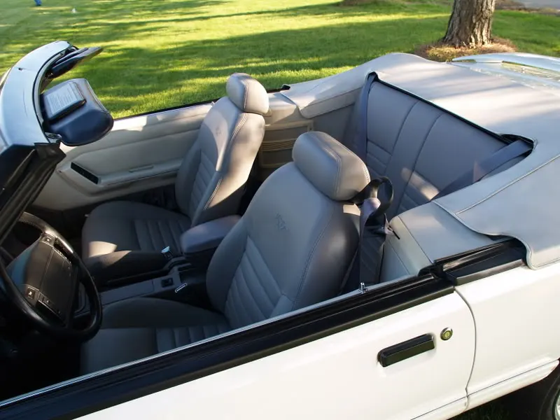

Sweet LX! Are the rear seats from an sn-95 mustang too? Nice job.

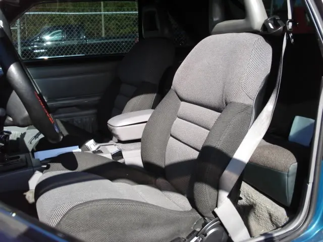

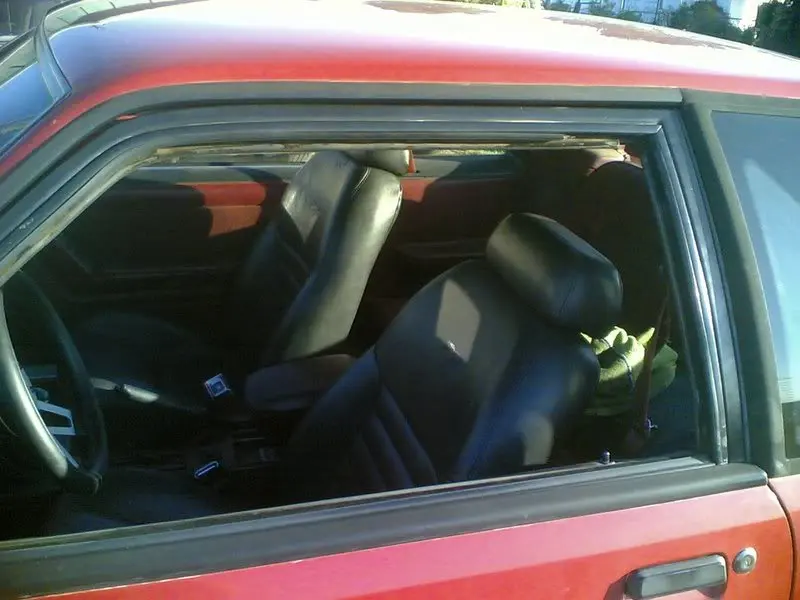

Mine went in with no problems at all, Do sit alittle higher though. But atleast I don't have the gangsta lean that I had with the original seats. And the headrests went right in with no problem.
