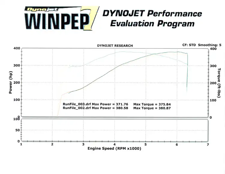

Here's the thread. The pics are gone as mustangmods went belly up and that was where I had all of my pictures hosted. The results were 9rwhp/5rwtq between a 65mm 94-95 setup with a ported elbow and a 75mm fox TB setup on the same dyno on the same day on my 331 combo.
http://www.stangnet.com/mustang-forums/753489-back-back-fox-versus-94-95-tb-dyno-results-inside.html
Edit, here is the pic that doesn't show up in the other thread:
My results:
