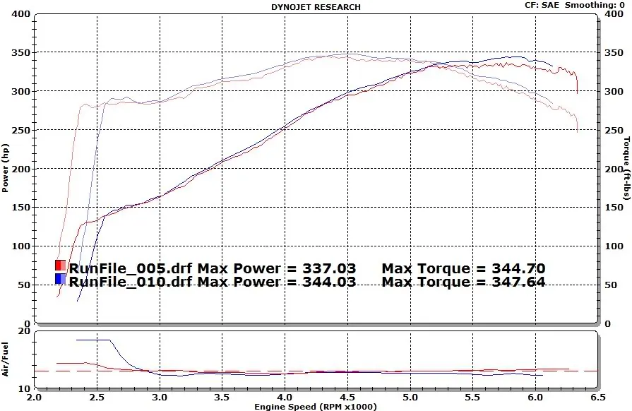

I agree a 75MN Accufab will flow more then a 75MM BBK but thats just how it is. If you dont do the same size then everyone says...well it pulled more b/c it was a bigger TB...so dammed if you do and dammed if you dont
I did pull more HP/TQ but over all the test is moot b/c I was able to pull 2* more timing then the last time so the HP increase was effected more by that then the TB swap. The car was VERY lean on the first pull. He had to cut it short at 4,000 RPM's b/c it was up it the 15's for A/F. He wiped the tune out and started over, made some adjustments and adding some timing and the final results are below. Before it pulled 338/342. It gained some up top and most of the RPM range over the previous graph.

It was lean ???? Did you mention how it was woofing fuel and the milage? I woulda thought that thing was fat for sure.. he left the Cobra tune in there?

I was talking to him about that and it was right around the same time the gas stations were going from the winter to summer blend of fuel. Looks like my car does not like the winter blend very much. That was the only time the fuel mileage was that bad. Even before today it was not that bad as before.
It was deff not rich haha. What do you mean by leaving the cobra tune in there? He wiped the previous tune out and just started over from scratch. The tune that was in the chip was so far off it was not even worth trying to work with it.

Thats the whole point. Its not just a TB debate for a SN95 TB or a fox TB. Its the entire set up, that includes the pipe that is used as well. Its the entire set up as a whole, not one specific part of the new set up. Its not a TB comparison, its a Fox TB set up comparison which includes the inlet pipe.
IMO my res are not conclusive. Rio said he saw some power increase as well as Paul but half say its b/c of the bigger TB. While my TB stayed the same size I also had a increase in timing...why...I dont know it just liked more timing this time I think it took as much as 35* w/ the base set at 10. For what its worth I'll consider this comparison of the SN95 VS Fox set up as unresolved.
