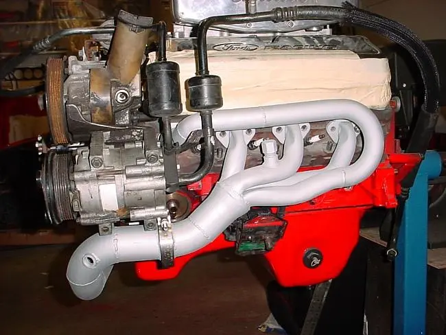

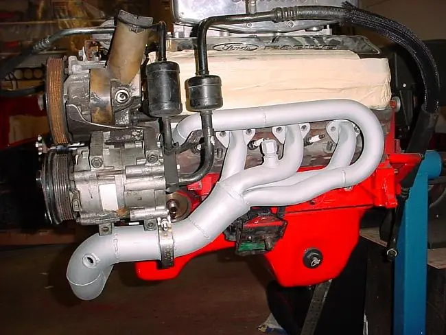

Ok guys, i was on here and I came across this post and saw a set of headers that OINKAODEOINK made for another member and it answered alot of questions for me "like how do i keep my A/C and do my Twin Turbo System?"
This guys work is so good i had to brag and give him some shine on SN.. :hail2:
So check these out.
attachment.php
attachment.php
Labora, you have great eyes.. yur right, Oink took the headers off before they were fully cooled down and he is fixing that problem now... Glad he caught it before he shipped them to me.. as for how much
That something you guys will have to take up with Oink
I supplied the header, and Oink did the work for me.. I'm a great welder but I don't have a welder at my home, and Oink is the man when comes to this stuff so i sent my header to him.
I paid $169.00 for a set of MAC shorties and OINK did the MOD for $70.00
lol, you went and posted pics of the header before it was finished. It's all good, the header is good to go and on it's way to you. Curious what you plan on doing with the headers, as in how do you plan to place the turbos, and route each pipe to each turbo?

Oink, i'm going to run the manifold exhaust so the turbos are right in front of the front tires, tucked in were your horns are.. Then I'm going to run the exhaust from the turbos through the A-arms (coil-overs needed) and have them meet back up to the H-pipe right were the 45 degree bend is.
I'm also thinking about putting in a Y-exhaust right that i can open and close electrically from the cockpit for racing... Have to see how my money runs after i get all the parts together.. those things are $200 each.. still saving for my wastegates
