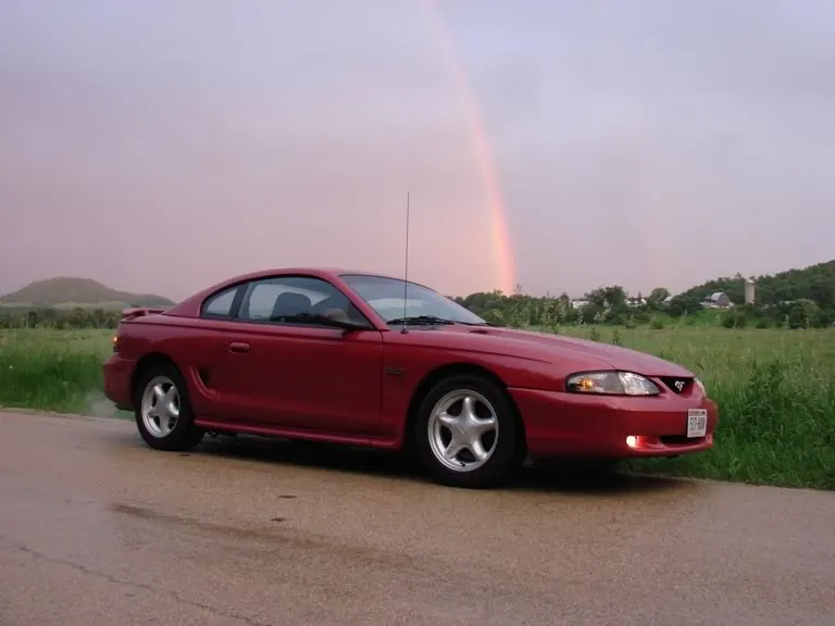

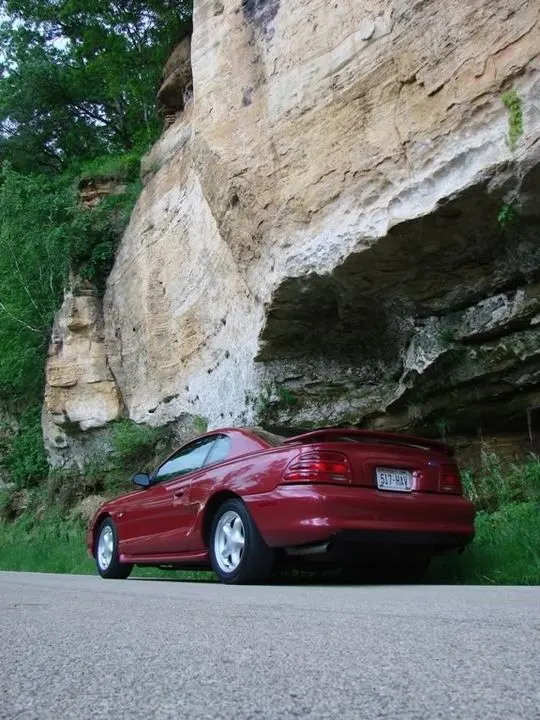

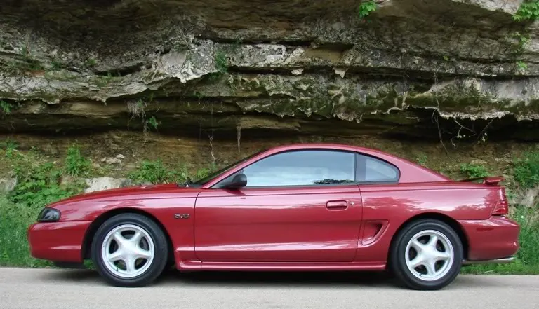

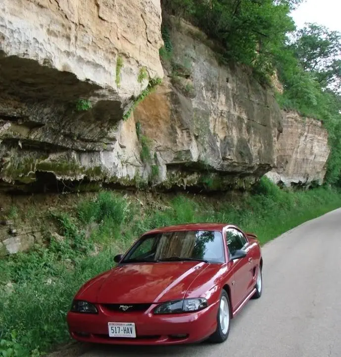

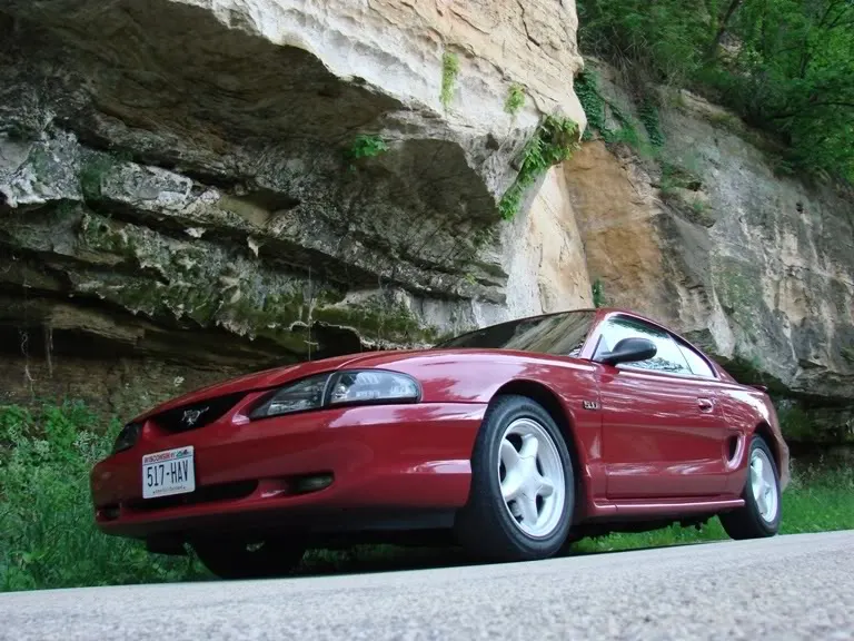

I took the car out and got a couple pics before it started to rain, then I got a couple of pictures while it was raining.
I've had the car for going on 4 years, and this is the first year I did something for the exterior, so I thought I would show it off a little.

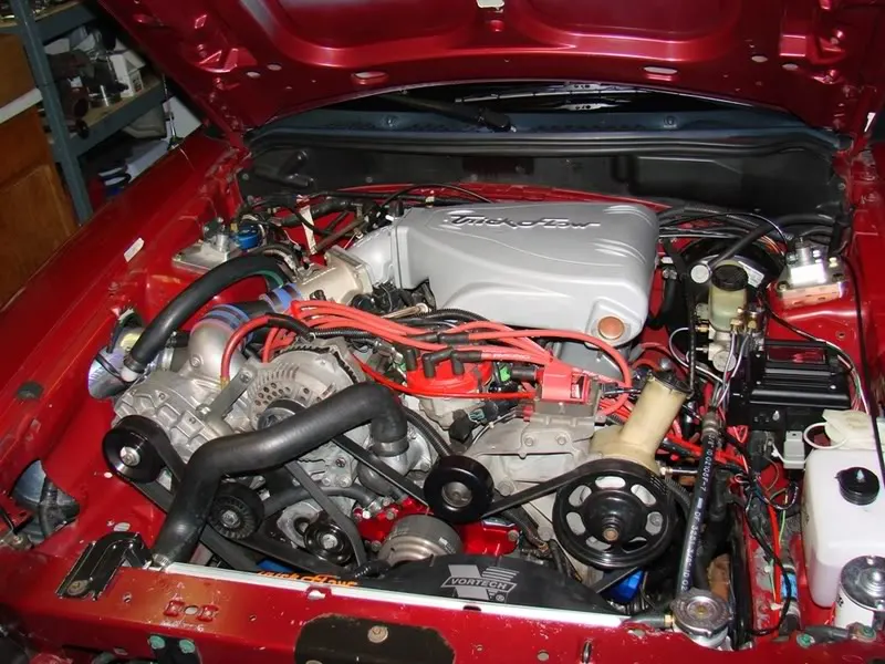

So far the upgrades for the year are a PA Racing K-Member and A-Arms, Strange adjustable Shocks front and rear, Coilovers with 14" 175lb Afco Springs. HPM Caster Camber Plates, Electric Water Pump, Fluidyne Radiator, smoked headlights, corners, foglights, and some Corbeau A4 seats.
Still in the garage to do yet is a MM rollbar and subframe connectors, McLeod steel bellhousing, Corbeau 5pt harness's, Superior 31 spline axles, Eaton Posi, and a Ford Racing girdle

And here is a picture under the hood. It really isn't too much to look at under there, but it gets the job done.
Man talk about a sleeper. :eek:
The underhood shot is awesome. The car looks good too. All you need are some new wheels. And I have the same headlights. Good choice. :nice:
