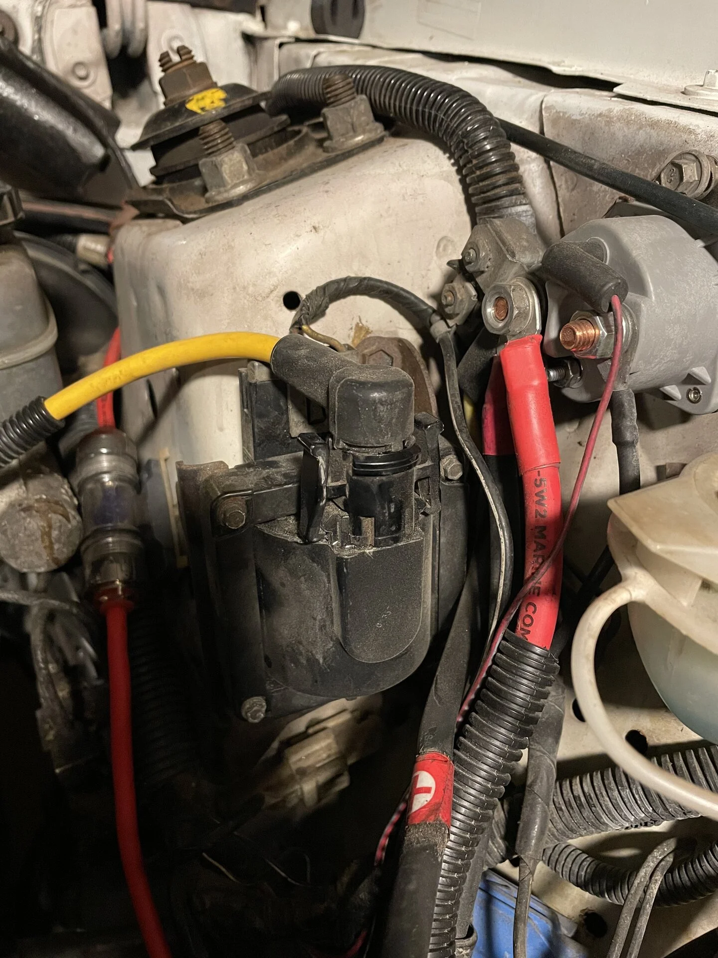

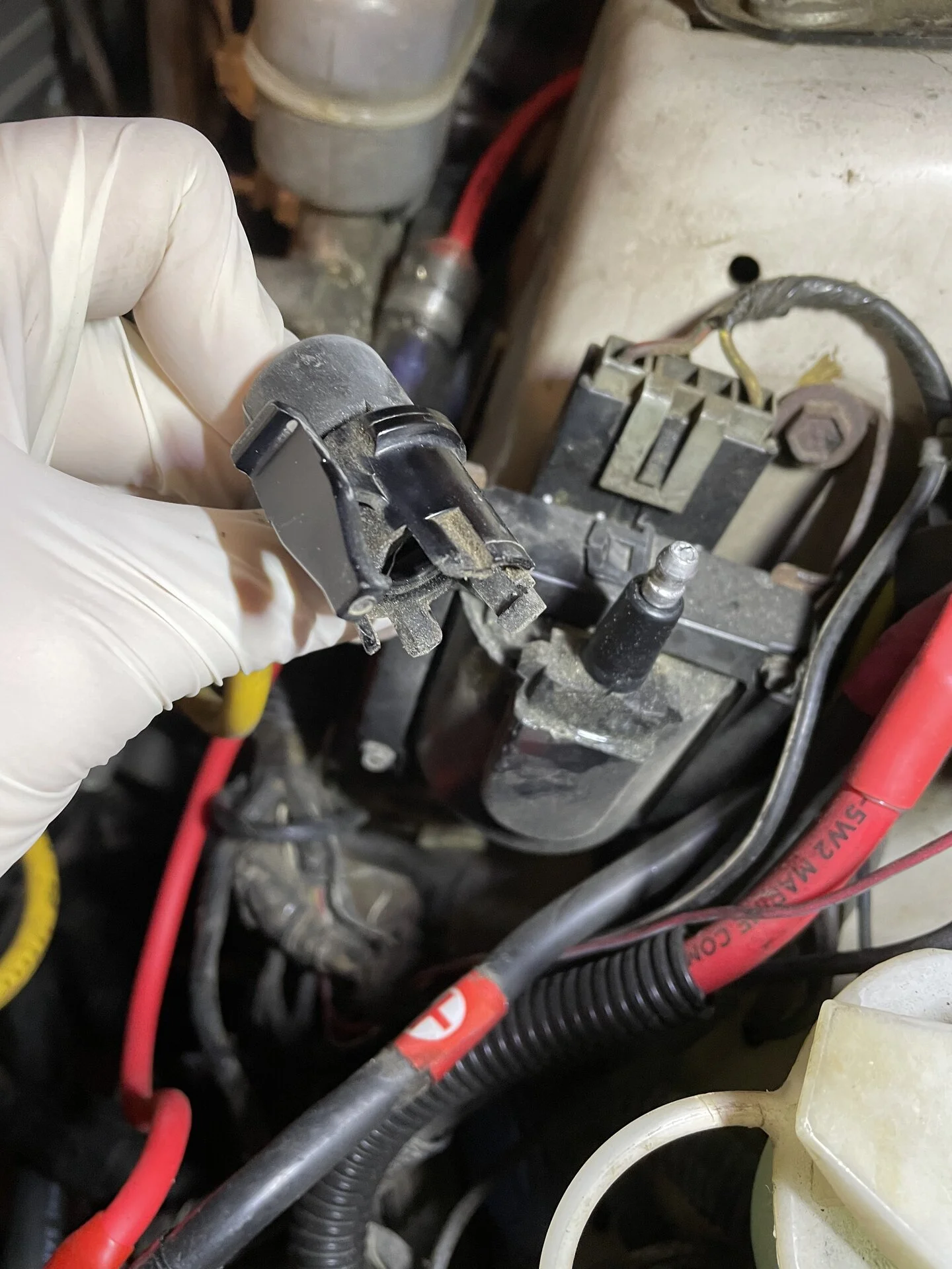

Why does my ignition coil spark plug wire connector not look like any I’ve seen on the internet?
It’s not coming off like it should, I would think. I’m pinching the clips and pulling pretty hard but it isn’t budging. What am I missing?
Looks like you could squeeze the tabs with a pair of pliers then twist and shout
swearing optional.
Have you tried pushing down initially as you squeeze, it will take any tension or friction the clip tabs have off. Then twist and pull.
Reactions: JAA
I hand this gold star to KRUISR.

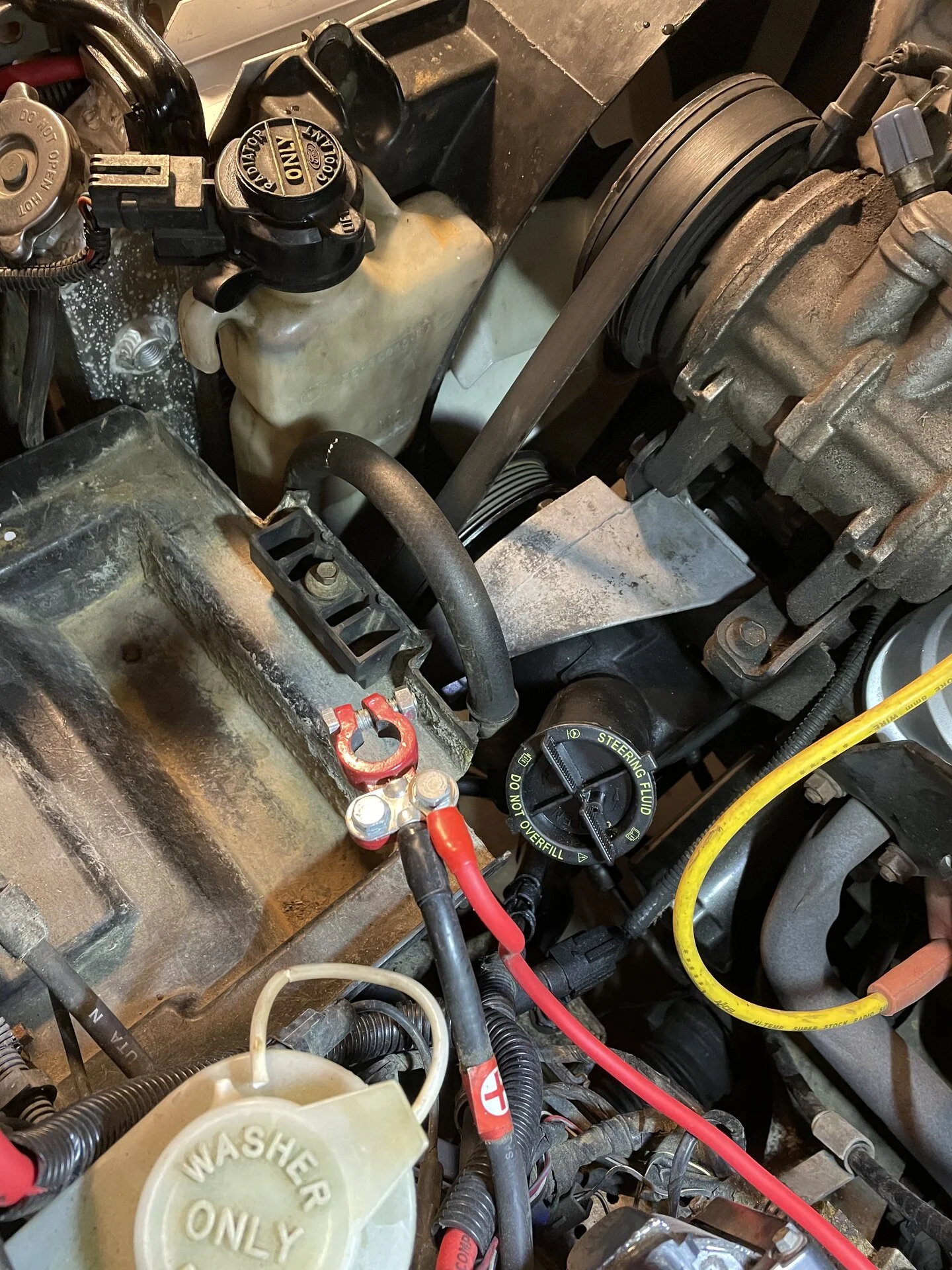

What is this monstrosity?

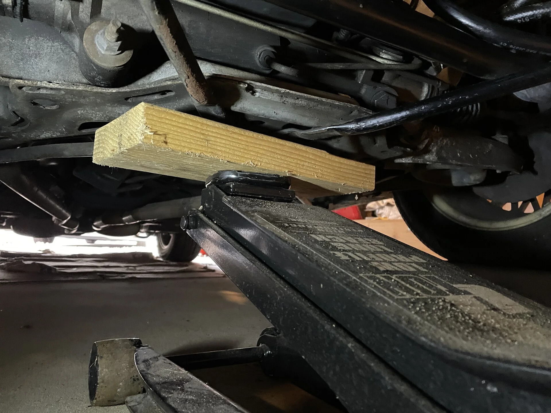

Block on the k-member, gonna get the stands.

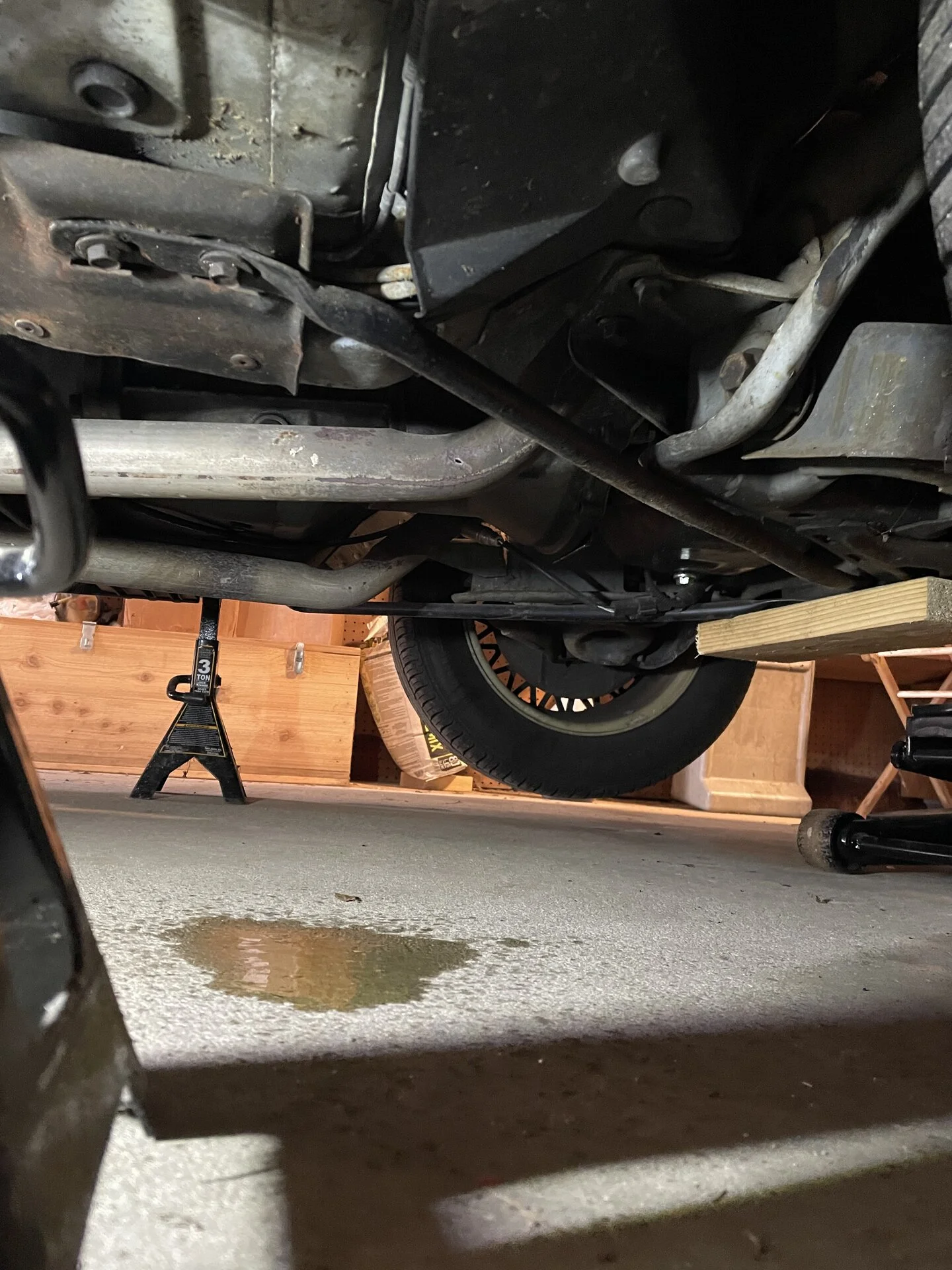

Heater core? I’m guessing as I knew I had a leak but only when I had blender door to hot.
This started dripping when I brought the car onto the stands.

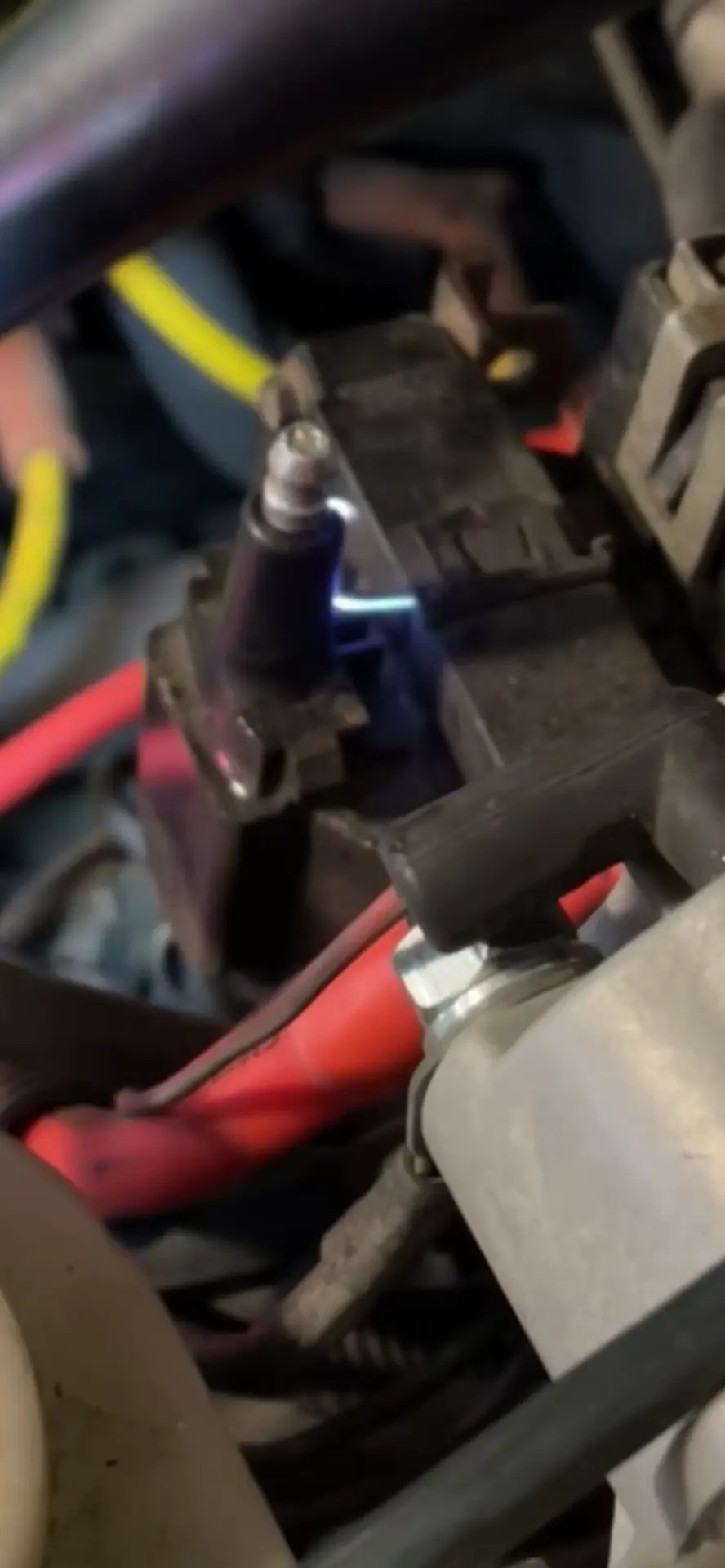

My coil pack is arcing to isteself. I assume this should be replaced? Does it matter which one? LMR seems to sell some beefy ones, are any of the upgraded ones worth it?
