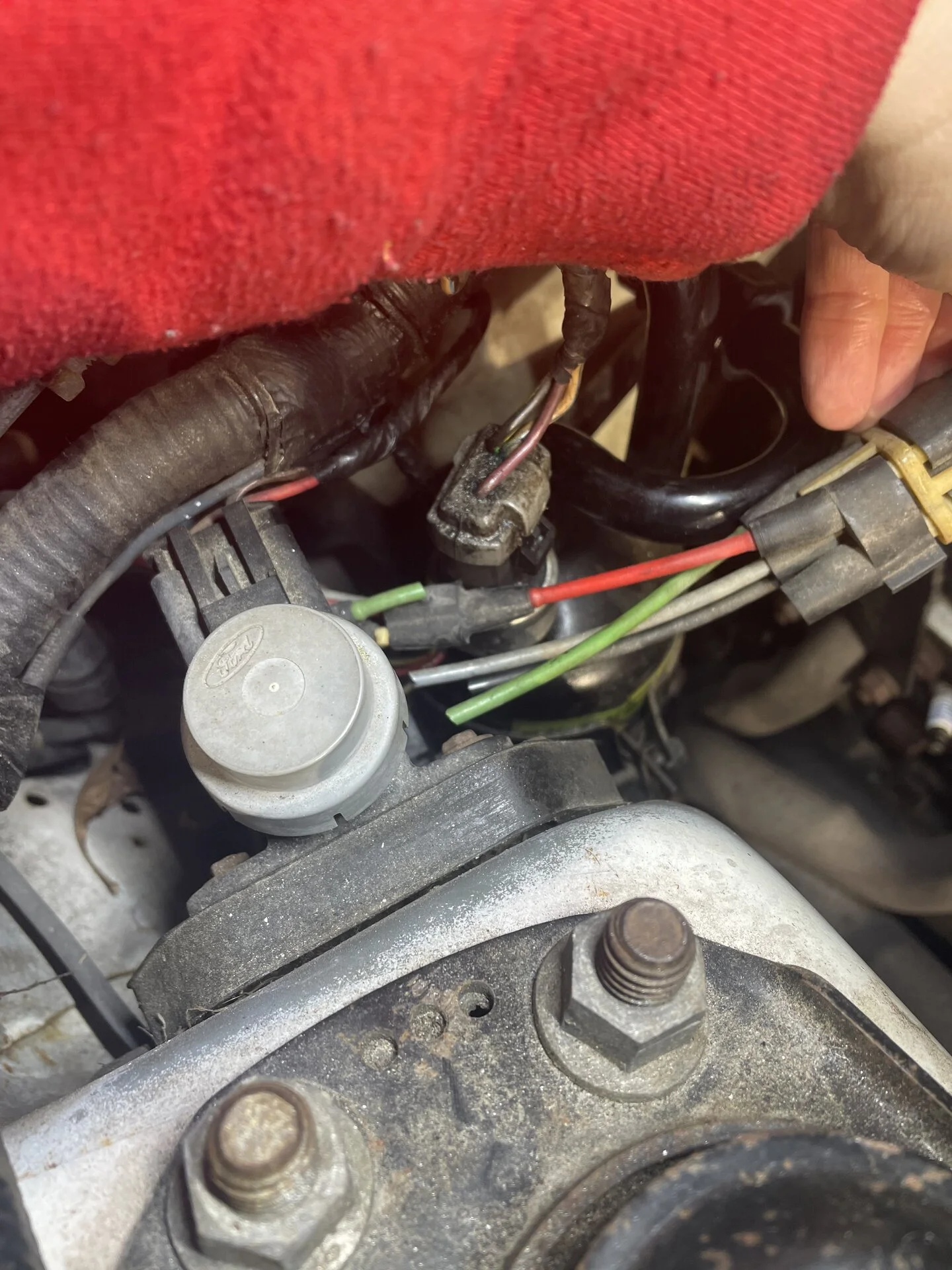

Well that’s something. I think I just snapped a bunch of vacuum lines moving them out of the way. I mean, I know plastic becomes brittle over time, but cmon. Lol
Looks like the only broken one actually in use is green. Yay

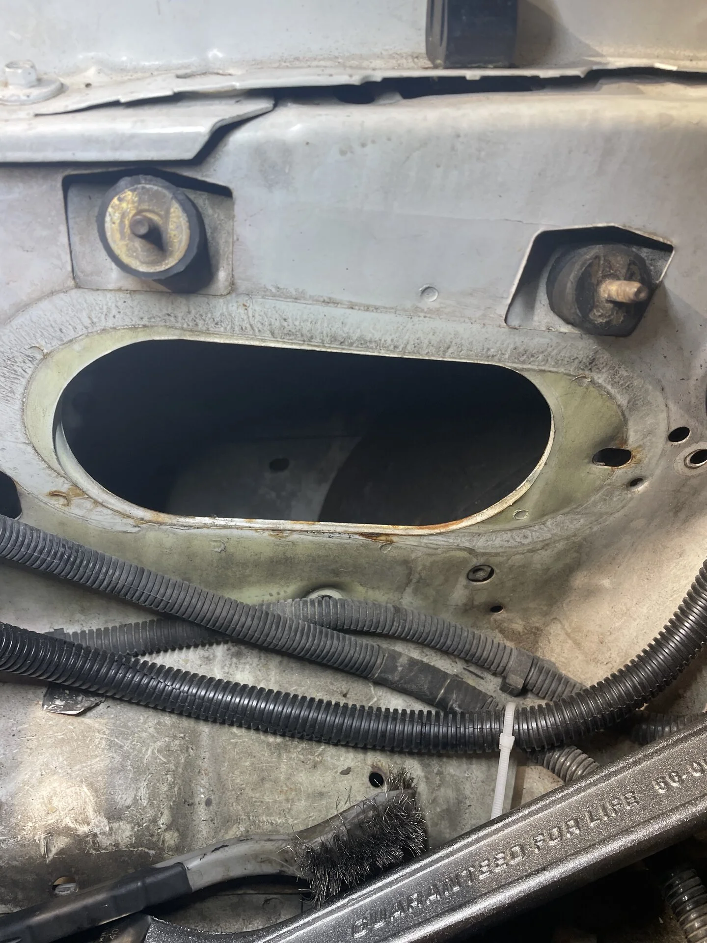

This means my silencer is already removed, yea?
BlakeusMaximus
Still got to try a little lube on my speedo head
5 Year Member
Jul 12, 2017
2,477
1,348
173
Dec 13, 2022
#272
  • Dec 13, 2022
  • #272
Yes sir
