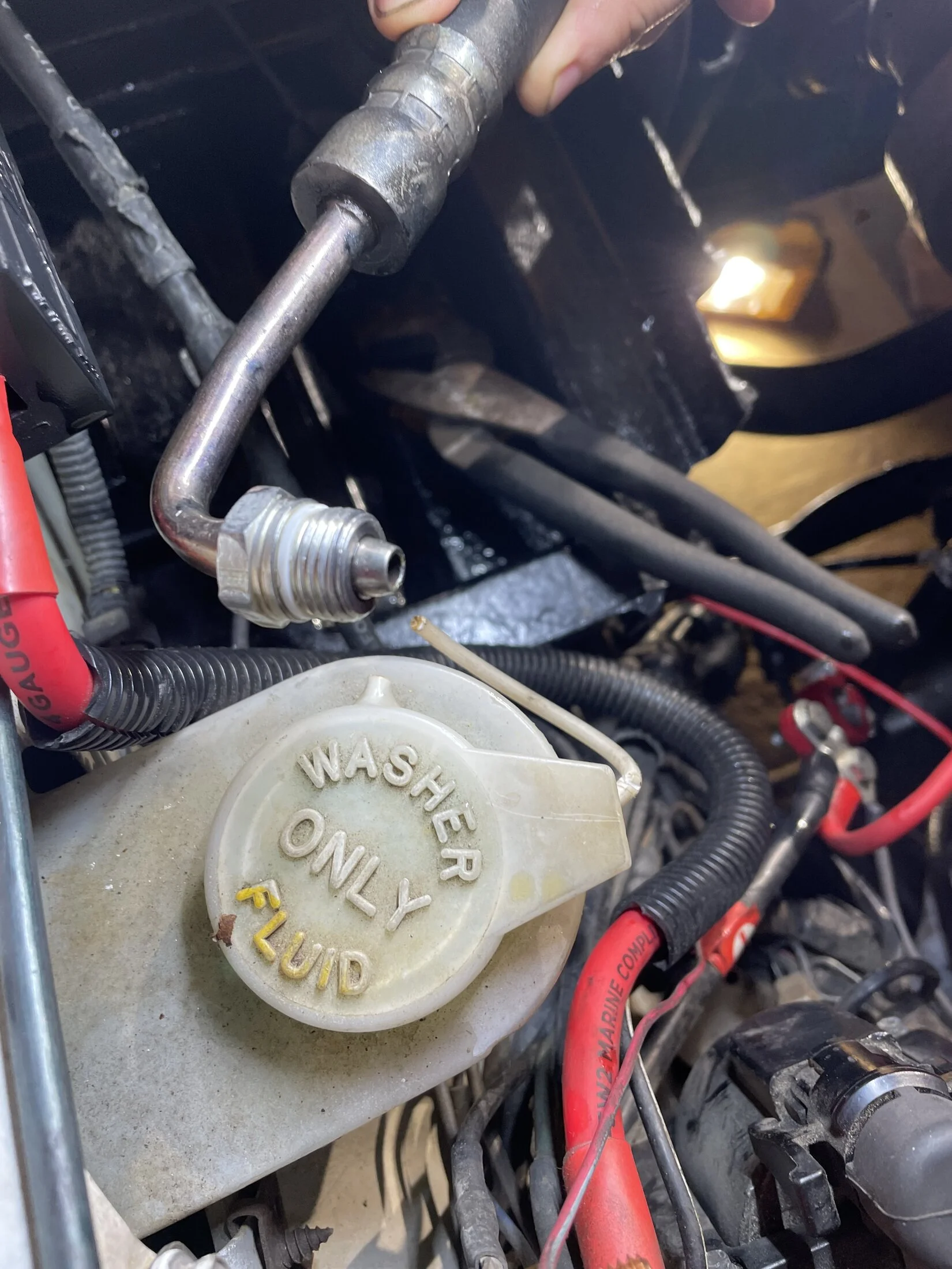

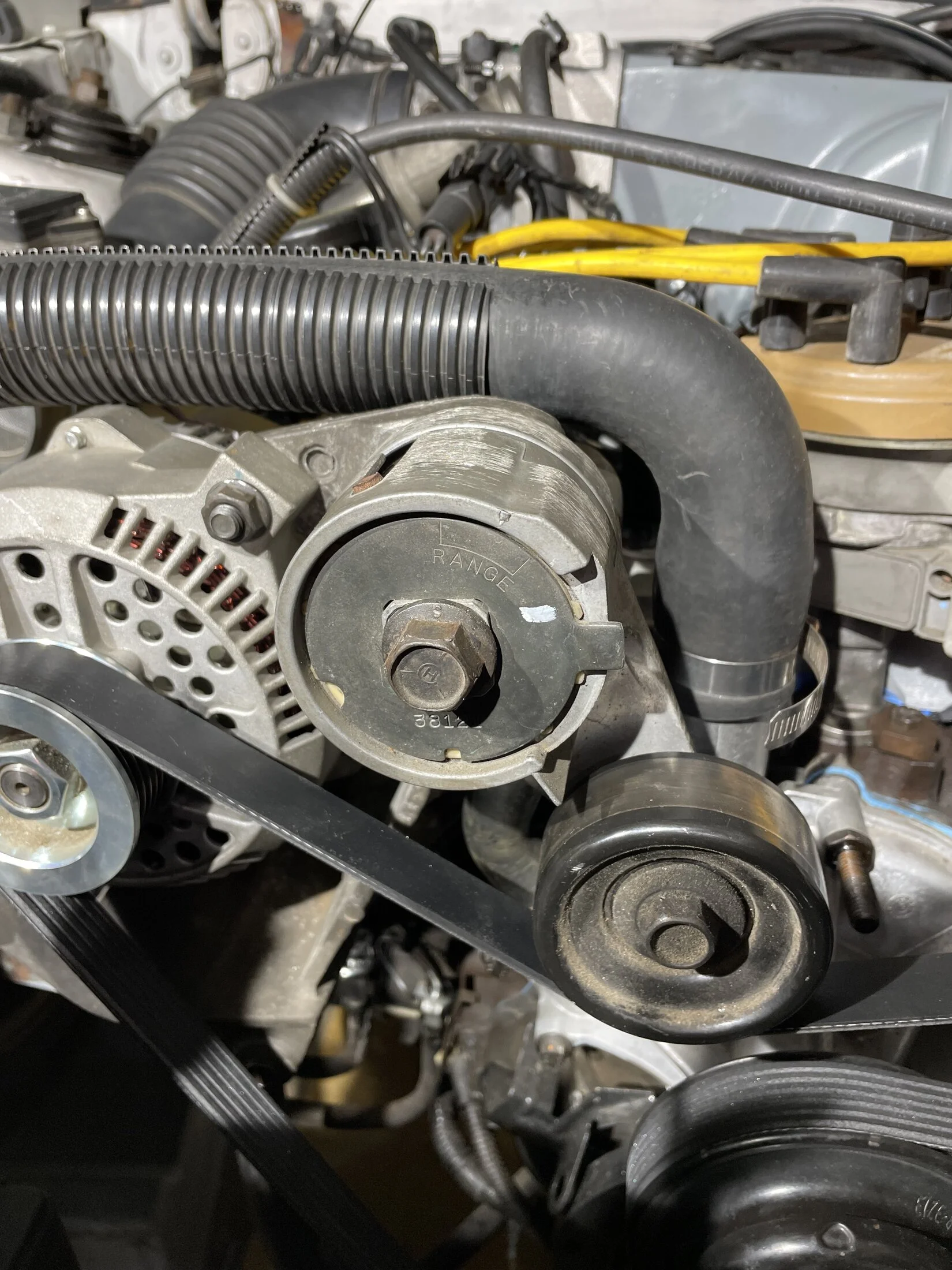

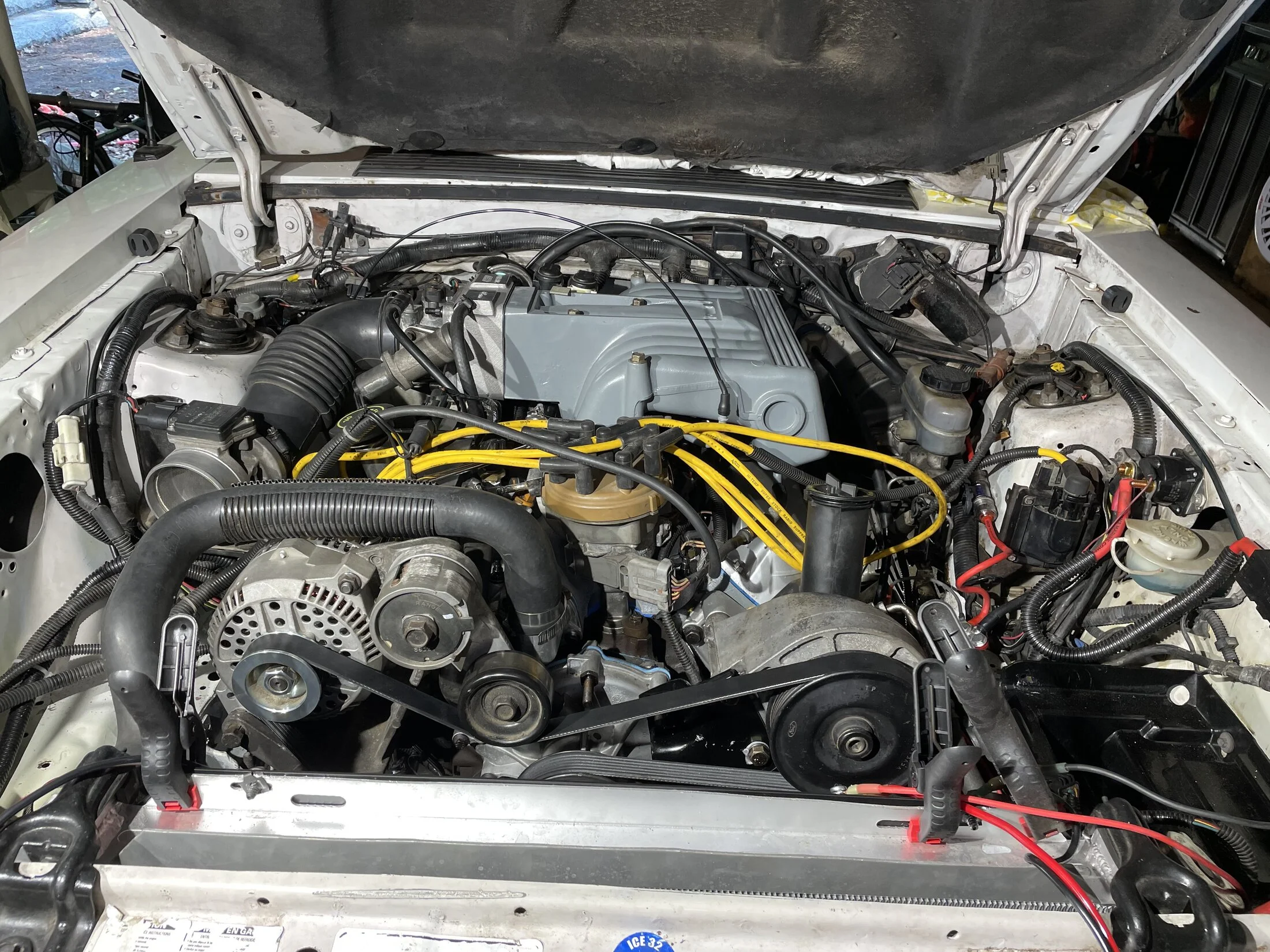

Belt and ground done
Gonna fill the radiator and PS pump. Then I think it’s start time.
What am I forgetting?
I havnt wired the temp probe for the fan. Gonna wait till I know the car starts. Once things seem OK I’ll fit all that wiring and remaining lines proper. I’m of course speculating that the vehicle can run 5-10 min before the thermostat even opens.

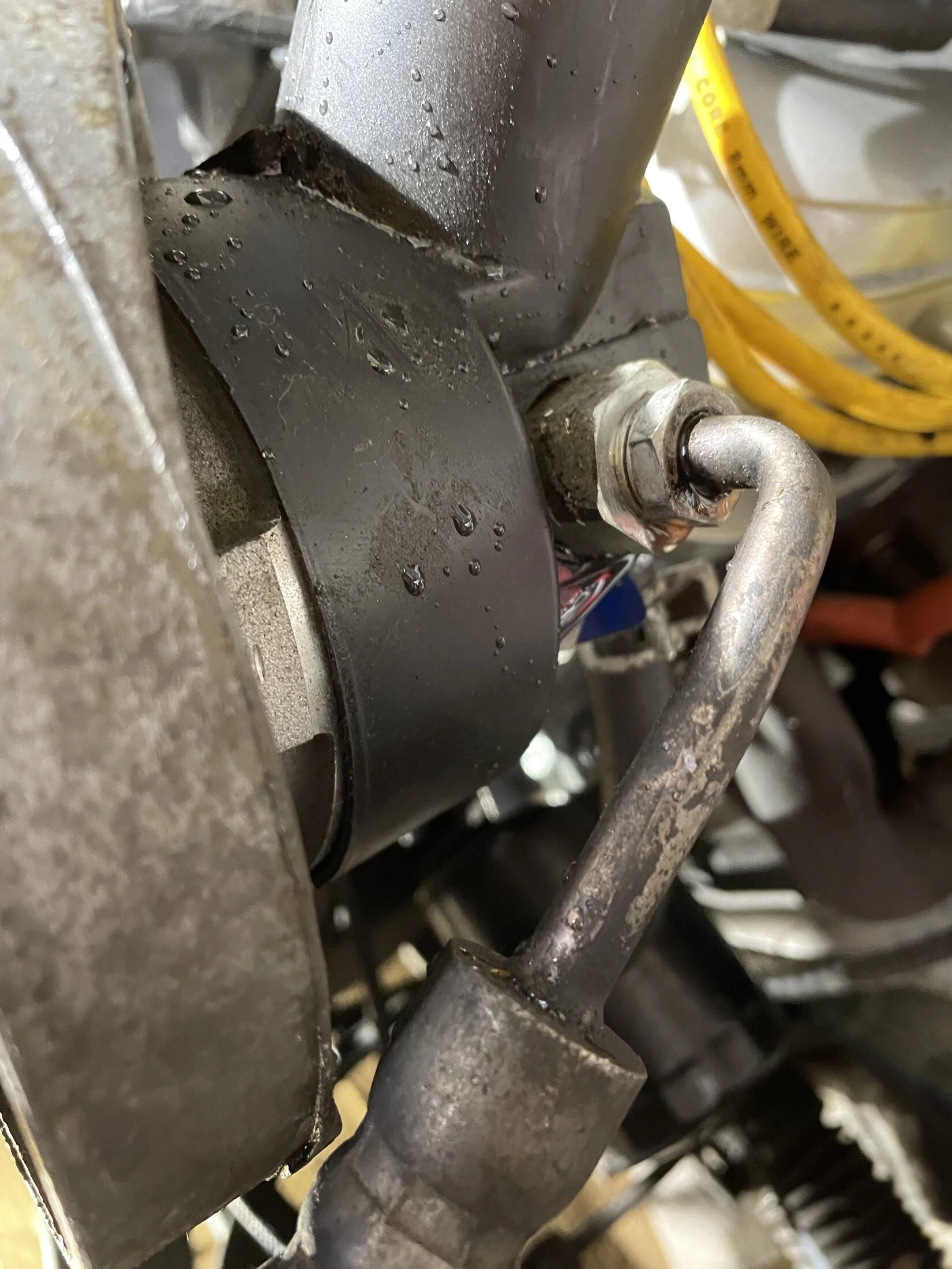

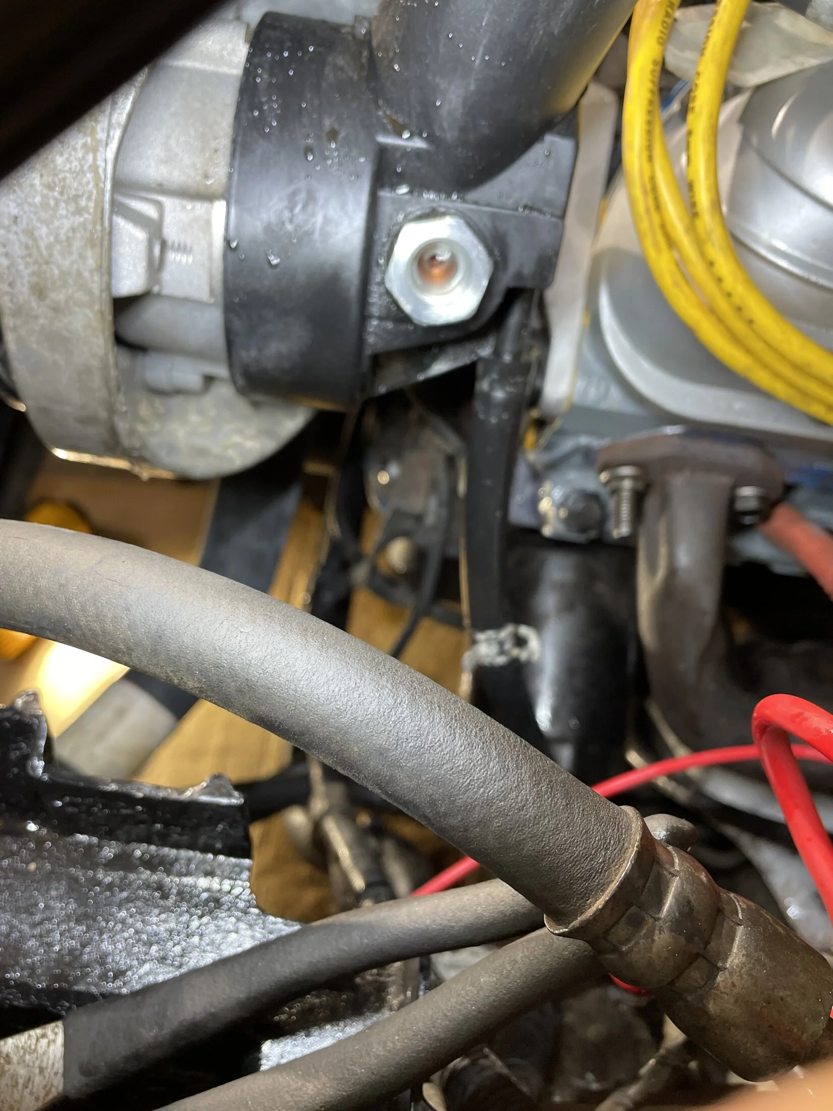

Priming the PS - I def have a leak below. It seems to be coming out where the tube meets the first nut.
I’m inclined to continue to start it up and see how it goes before fixing this leak.
Oct 28, 2001
6,114
4,212
183
Claremore, OK
Jun 11, 2023
#767
  • Jun 11, 2023
  • #767
That's the high side so it will spray fluid all over the place. Usually its the o-ring that is bad when it leaks there.
Reactions: JAA

Good thread on the o-ring ordeal. Read all the way to the end as my guess is you have the Type II and can replace the o-ring.
Fox - Help With Power Steering Pressure Leak
Quick update: LMR replied to my email, not addressing the leaking hose at all and just saying: "That rack will use any of the hoses since the main difference is the length between the years and with or without AC. The fitting where it going into the rack is going to be the same on each hose" I...
stangnet.com

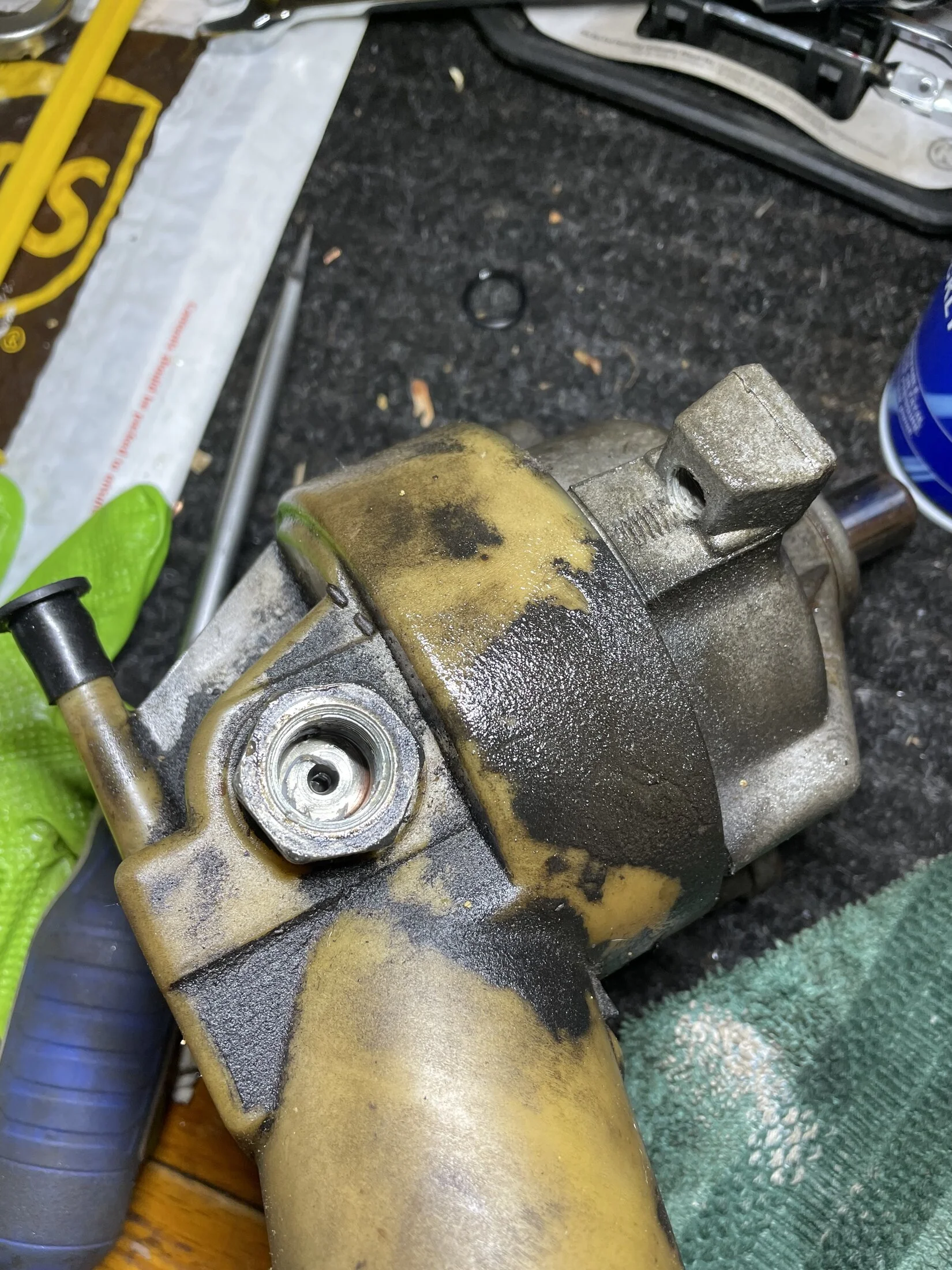

And here is my old pump. Def different

I tried a Danco #6 oring, didnt seent to help at all.
This leak has been there since I replaced the PS pump a while back. Im going to start the vehicle to test things out. Then I will need to decide whether or not to go back to the old pump or replace to the new line (which I have but never installed, didnt know I needed to).
