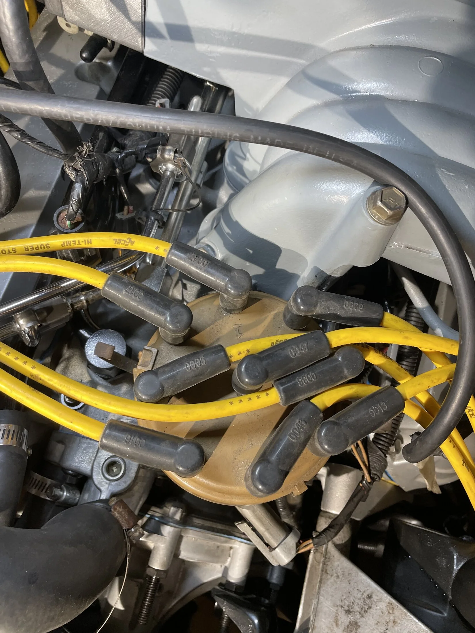

Well, that was one heck of a backfire. Pure gunshot, wish I would have recorded it. Scared the dog senseless. Though ive now figured out how to wakeup my 19yo before noon!
Here is the firing order I thought I used: https://lmr.com/products/302-firing-order

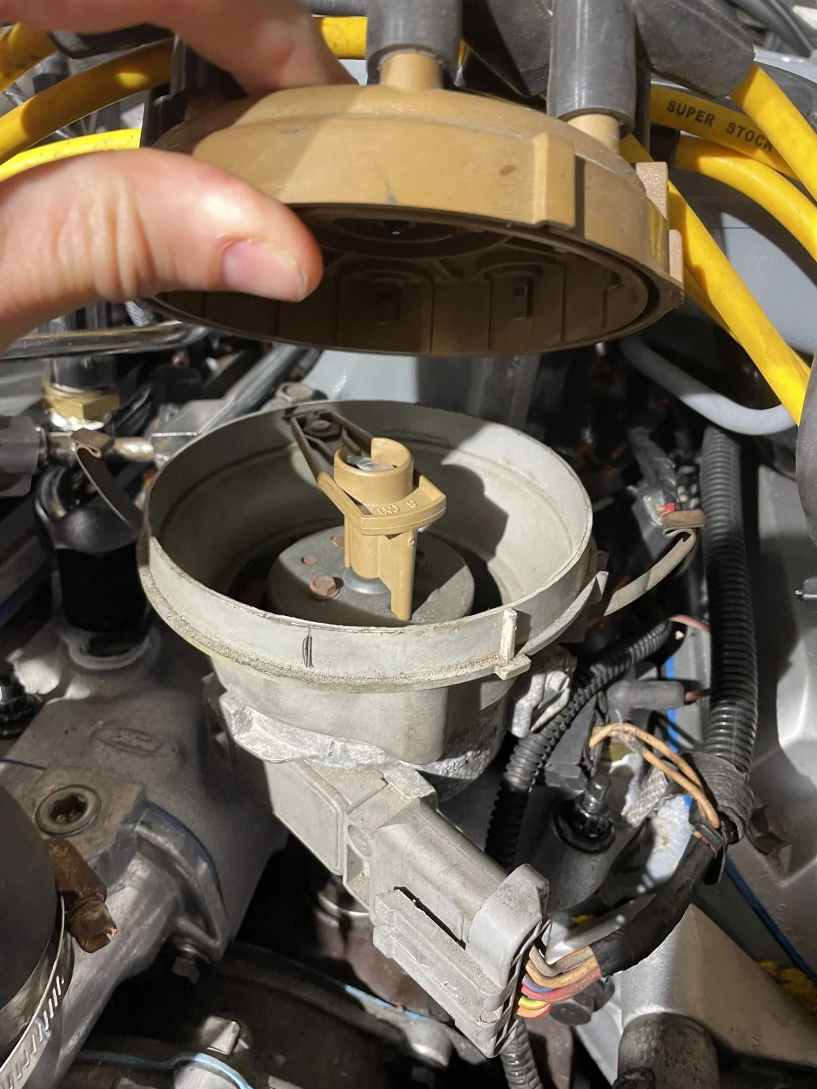

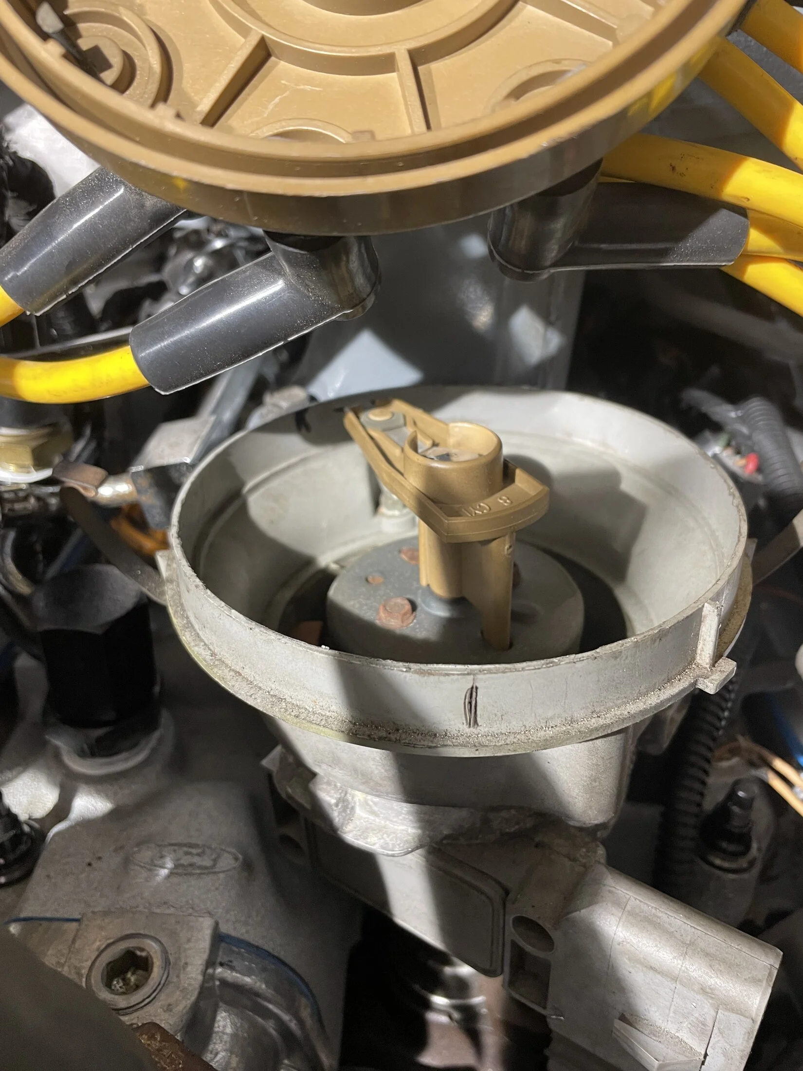

It’s lined up where I intended it. Harmonic balancer says TDC and dizzy is pointed where I wanted it. Pointed at spark plug 1 on the cap. I’ll add my reference pic in the next post.

Reference pics of distributor and rotor

Looks one tooth off to me
You sure it's on the compression stroke?
Im not sure if you are kidding about the single tooth? I can def move it and try again.

Im speculating it could have not been on the compression stroke. Do I just readjust the distributor? Does this mess up my valvetrain?
General karthief
Mod Dude
Aug 25, 2016
28,030
10,656
213
polk county florida
Jun 12, 2023
#795
  • Jun 12, 2023
  • #795
Ok, don't start jumping around, check and recheck, pull the #1 plug, turn the engine a complete rotation, as the piston comes up to TDC you will feel air pushing out the plug hole, I stick a screwdriver in to feel piston movement, stops moving up the 0* hash mark on the balancer will be at or very near the pointer, you marked #1 on the distributor right? Make the rotor point to that mark and it should start, then you can set timing with a light.
