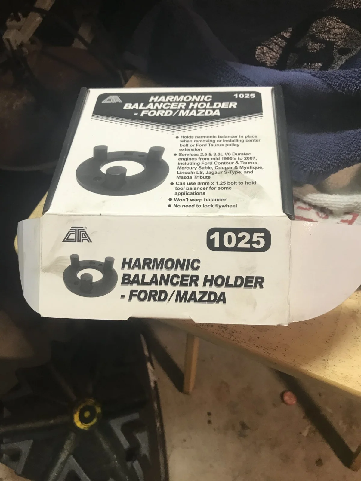

Autonze gave me this for the harmonic balancer removal tool. Wtf is this?

Fn harmonic balancer is stuck like a mofo. I have the right tool - its a little hacked cause the bolts were bent, but the HB is refusing to budge!

Make sure you took the bolt out and the washer too

yea - turns out the tool was a bit harder to use than expected
