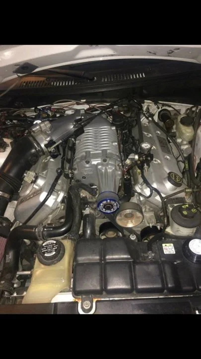

My car has been down since February when I blew the oil pump during a pass at the track and spun a rod bearing. We've finally got around to tearing the motor down and it doesnt look good....at all. A rebuild would be costly but I caught a break........
Managed to find a guy selling this for $2500 (without blower/intake)
Runs perfectly fine. Originally wanted $3K but I was able to talk him down to $2500. I guess Im not going to be a 2V guy anymore :(
Pretty sweet deal! Yea it seems a lot of us are having some problems this year, lol! WTF man?! So what are your plans with the Termi long block? Throwing a PD on it? Centri with an intake manifold adaption?
You should def swap the ECU. 4V engines have IMRC plates and knock sensors that the ECU control and monitor. You could delete the IMRC plates like some do. And you could also remove the knock sensors. But it might be easier to just get a 4V ECU. I personally would not feel comfortable using a 2V ECU on that set-up even if it was tuned.
Im pretty sure only the 96-98 Cobras had the IMRC's......but the 4V ECU is a good idea
