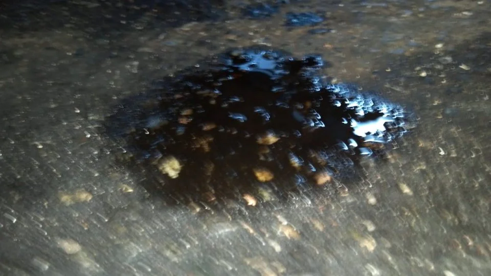

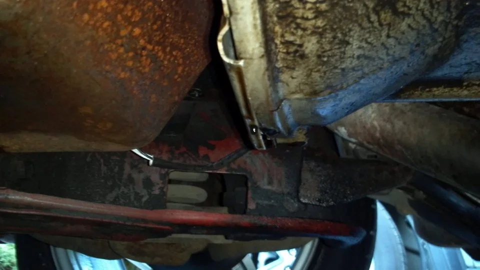

NOW - another side note, the car leaks some oil (what car doesnt, haha) but what worries me is where this is coming from. It was NOT this bad before I did my oil change (still using 10w 30), and what im afraid of is it might be the rear main seal. Could it be coming from the back of the lower intake manifold?
The splat on the ground in the second picture is about half the size of a DVD or CD, so, quite a bit, and you can see its coming from between the
ok your oil leak is likely the rearmain seal... mine leaks too. How often do you have to put oil in the car? if you have to add oil between changes then it is a bad leak.
--or--:
That oil appears to be coming from outside of the bell housing. Rear main leak would come from inside. Can't rule it out on this picture alone but the inside lip appears to be clean. Your leak looks to me like it's a lower plenum leak. Get a look behind the motor with an inspection mirror and see if you have oil running down the backside of the heads before pulling everything apart to replace the rear main seal.
