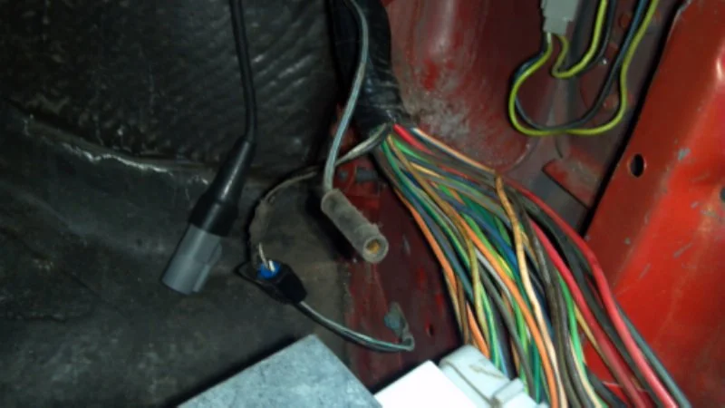

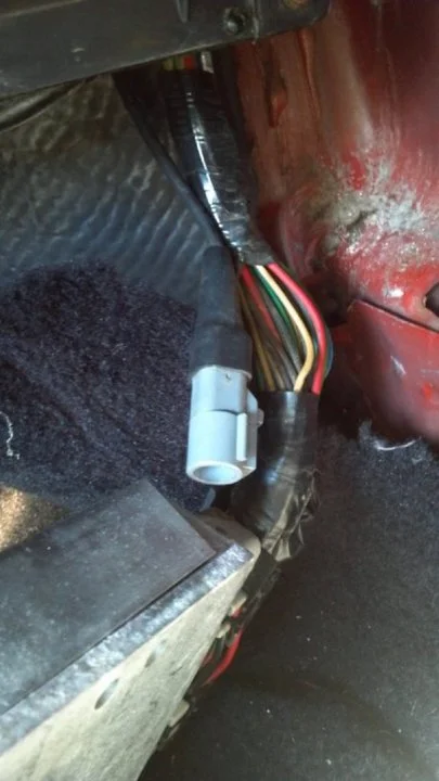

Since your car is an 86, and did not come from the factory with Mass Air, someone had to convert or attempt to convert it to Mass Air. It is entirely possible that the harness was installed but it never got a matching Mass Air computer.
Remove the passenger side kick panel and remove the two screws from the plastic computer mount strap. Pull the computer down so that you can see the sticker on it. Check the number sticker on the end opposite the wiring connector for one of the numbers on the cart below.

Hey guys - got some more info here, the ANSWER to the problem!
I took a break from looking under the hood for a few days, it was stressing me out, just had to take a step back and breathe. So unhooked the MAF connecter from the sensor and freeing it up to get some slack in the line, and saw that it was routed through the firewall thru an existing grommet. Reomved the passenger side kickpanel and unhooked ECU hold downs to bring it out in the open - and here is what i see...
That is the end of the MAF wiring harness that was connected to the MAF sensor. I was able to pull it gently from the engine bay side, and see it move up torward the firewall on the inside, and pull it back from the inside, and see the slack wire tighten inside the engine bay...
So now I need to make a decision - either remove the A9L to find a speed density ECU and hook that up and remove the MAF sensor and harness from the car -
a.) If i went this route, what other things would I need to make sure are in place
or work on splicing the MAF harness into the ECU harness, which I do have the instructions for (ty again jr)
b.) If i went this route, its obviously going to be more difficult, what advantages would I see in comparison to SD?
Just kind of taken back that it was something that simple, and should have been the first thing I checked... Is it getting power, if not, why

I have a few questions as im digging into this - see picture below
First question is - the wire that is branching off of the main harness and grounding to the frame- there is the blue looking connector with a wire cut off (to the right of the ending of the MAF connector), Im pretty sure that this is the ECU ground, but I do not know what was or was suposed to be spliced into this ground
Second question is - to the right of that blue connector, is what looks to be a vaccum line? Does anyone know what this wire is for? it is also mounted through the firewall, but cannot locate its end point, but I dont see anywhere to hook it up to, and dont know what a vac line would be doing inside the firewall of the car
Thanks guys
