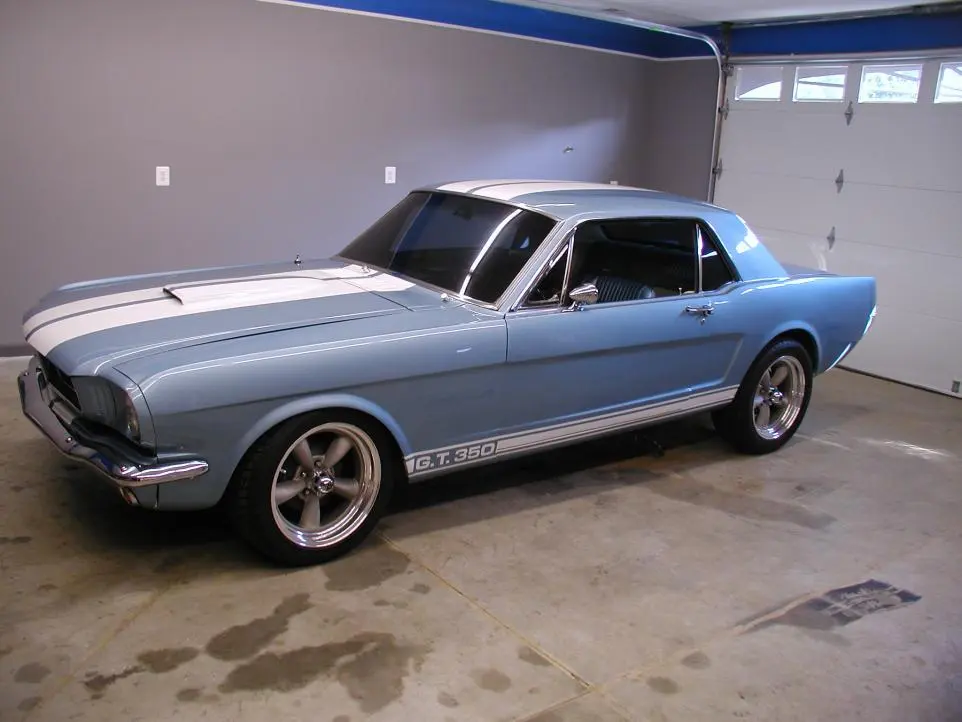

Here is a pic of my clone now.

I don't think i could sell a mustang to finance a project like this....though I did sell my 2.4 Turbo neon to finance it....I miss that car...just decided I would rather have the money in a car that I like better...as for the wiring....I'm rewiring the car from scratch...with a universal painless harness for the body...for the engine I will make my own harness....not to difficult if you understand EFI....my neon was on a custom harness...if you don't know EFI, its a headache to learn
