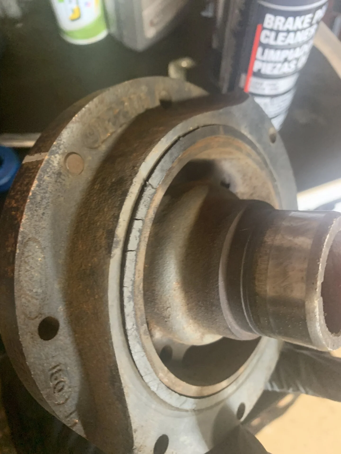

So replace the balancer… here is the worst of it. Vibration is still there though. Window seems to have gotten smaller from ~3300-3800 is which seems odd on its own. I did find that I was at 16 advanced to I pulled it back to 12. Maybe it is a misfire in that RPM range. Checked cylinders for misfiring at idle and didn’t notice one. Also? Checked primary temps and all are within 10 degrees of each other… already have an aluminum driveshaft, not that I think this is the case as it’s there while standing still and reving…
