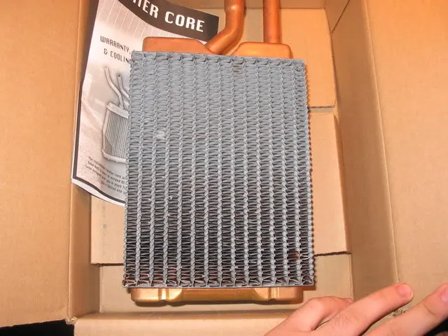

lol....got the heater core...such a lil thing that causes alot of problems...

I thought the same thing the first time I bought one. Just a cheap, simple little part, yet it can be so demanding if you aren't ready for the job. lol
Here are the Napa parts numbers if anyone is interested:
Item: Hose - Radiator Upper (U-shaped bypass hose)
Product Number: NBH10743
Price: 7.49
Item: Heater Core
Product Number: NHC6603126
Price: 27.29

this isnt so bad...been at it for about an hour now and all i need to do is drop the sterring colum and unbolt that dash...

i retract that statement^^^
****ing can not for the life of me get the WHOLE black unit to come AWAY from the dash.

I think the toughest part for me was getting the heater core out of the evaporator box, but putting it back in was easy.

thats not my problem...the problem is the damn A/C line..i think im just gonna delete the a/c.....unless i have any other options...? the a/c line is resting on the firewall and preventing me from droping the unit to pull the old core out and new one in...what are my options here...
NVM: i already got the a/c delete bracket that moves the P/S up so im just gonna do that saturday...anyone happen to know what size belt i need with just a deleted a/c? or should i just messaure it?

i just cut the a/c line and ripped the box out.....my old heater core is nasty looking.....i can tell its been leaking for a bit...ill post a few pics if you guys wanna see
