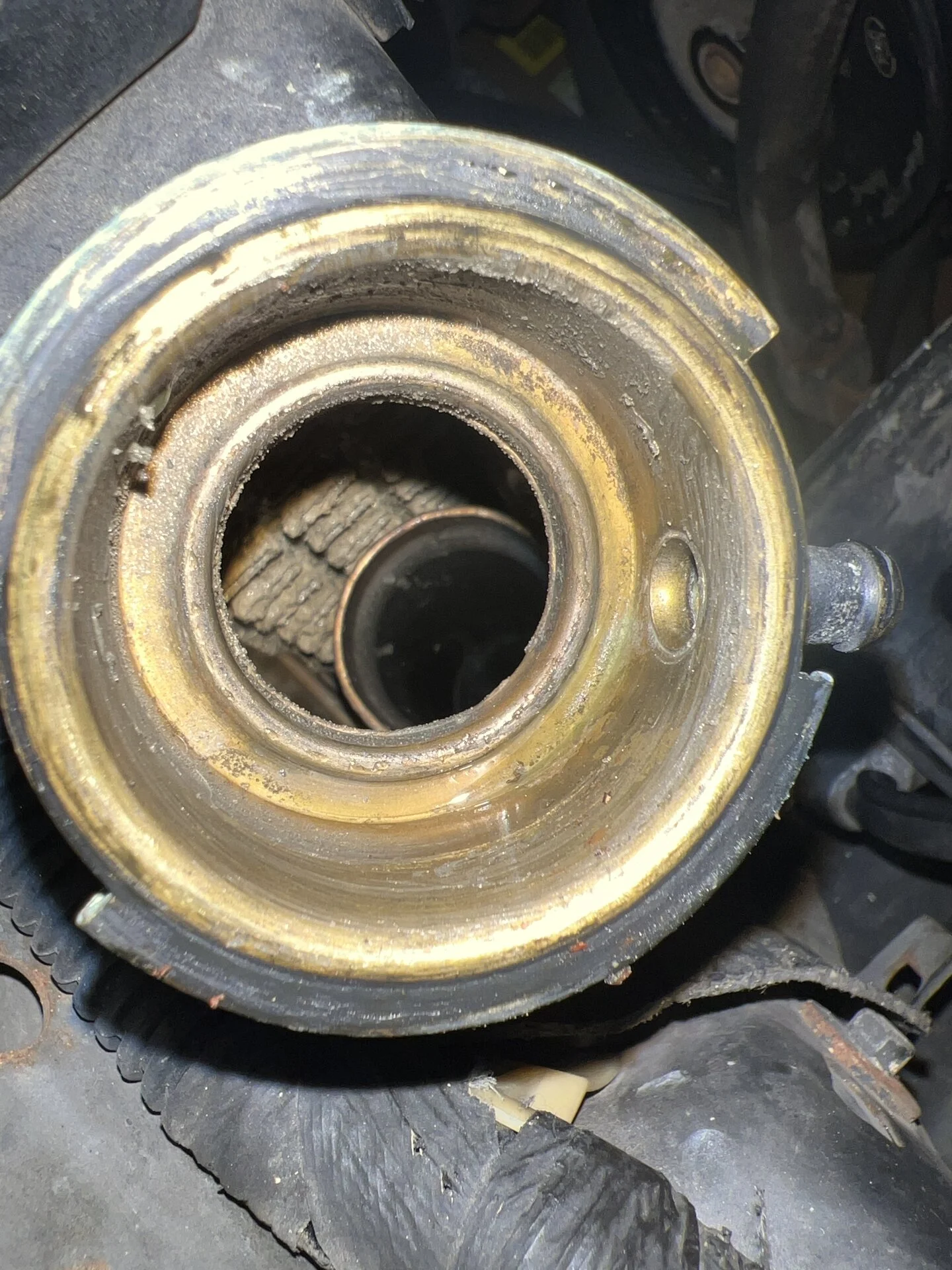

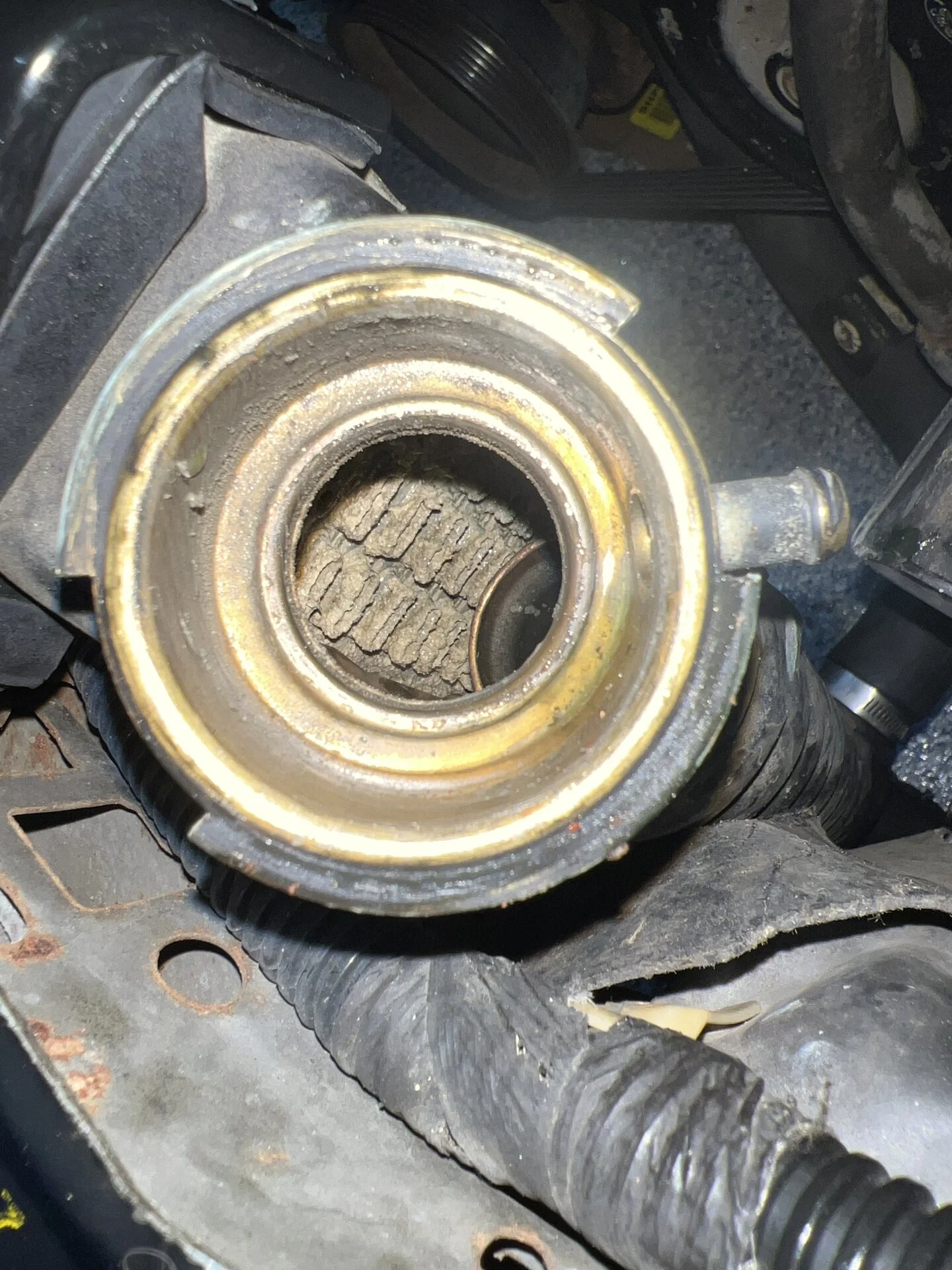

Yea that was a concern of mine I don’t want to make anything worse. This is how it looks on the inside from the cap can you tell if it’s in bad shape or not? I’ve already done a flush with just water in the past so it’s got fresh coolant.

Ewwww. I can see why you are wanting to flush the system. Anything strong enough to get that scale might expose thin or no metal below it like @rednotch is also worrying about.
Flush the rest of the system with clean water, drain it and use compressed air to help get it empty before adding distilled water and new antifreeze.
Somewhere in there I’d have the radiator cleaned at a radiator shop. Your heater core is undisturbed, the radiator is cleaned and pressure tested.
And if the hose is crunchy, even with the spring, or is spongy, replace them.
Typical for an old brass copper radiator that wasn't serviced much. Multiple water flushes letting it get to temp and cycle a few times with straight water, will knock most of it out without using a high ph flush to eat at the crude. Then just a 50/50 or 30/70 mix since your in fl with distilled water for the final fill. I've been using Toyota pink in my cars if it has an aluminum radaiator for the last 2 decades since working for them. normal green in my one car that still has an old gdi brass 3 core which I'm betting is what's in your car.

Its a 20 yr old give or take brass copper radiator, that's just calcium build up, none of the tubes looked plugged to me, if there's no signs of leakage when you remove it don't chuck it. Cap it and fill it with a water, vinegar mix and let it soak for a day or two will clean it right up, then flush it out with some baking soda and water.. You could probably sell it for more then the aluminum radiator your replacing it with. I've never hard a cheap China aluminum radiator last like those old brass copper ones.
