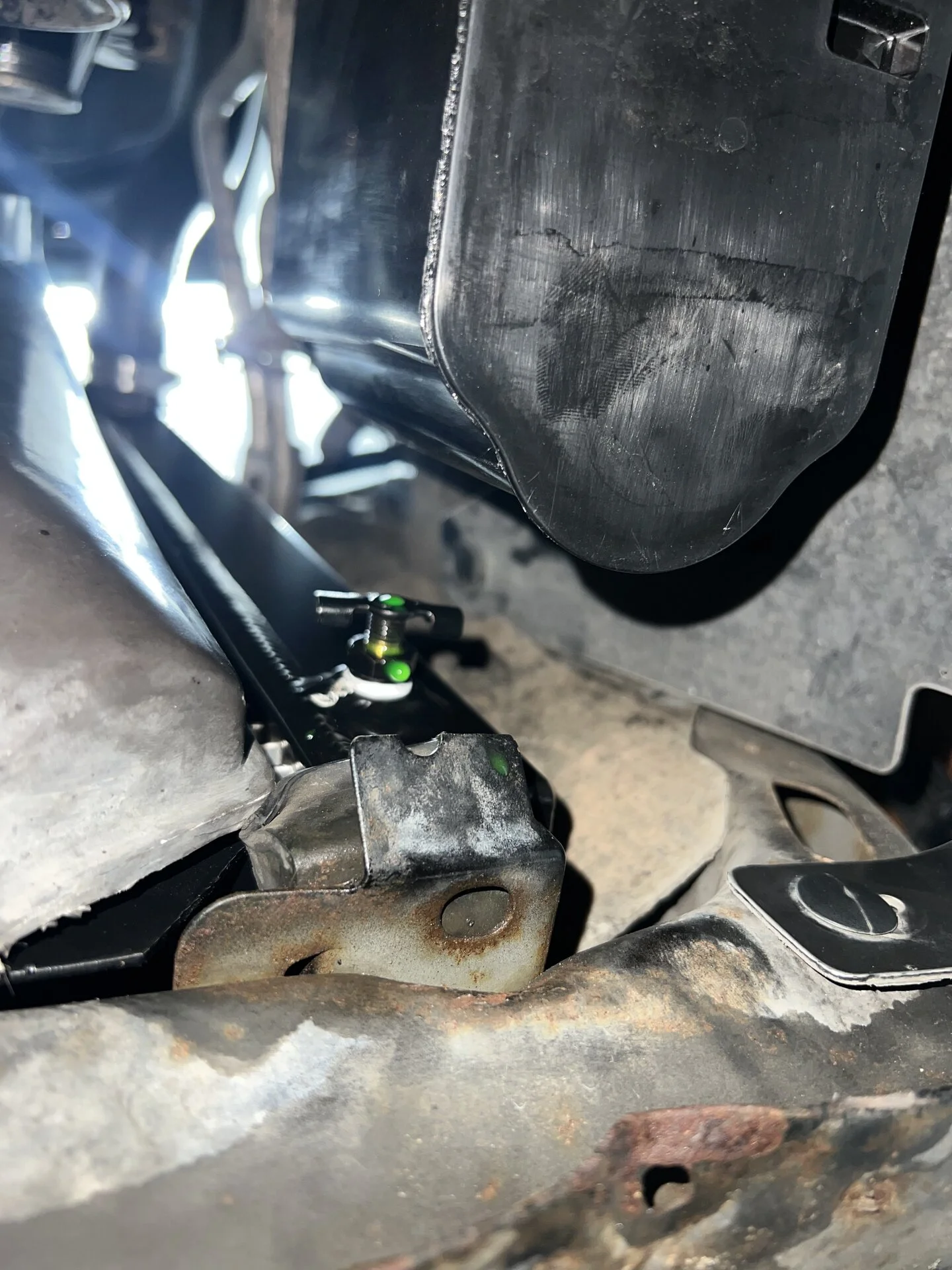

Can anyone tell me how you remove the drain petcock on these radiators. Mine is leaking from the wing nut looking things threads. I’m trying to take it off so I can wrap some Teflon tape around it but when I unscrew it all the way it just stops and won’t come out.

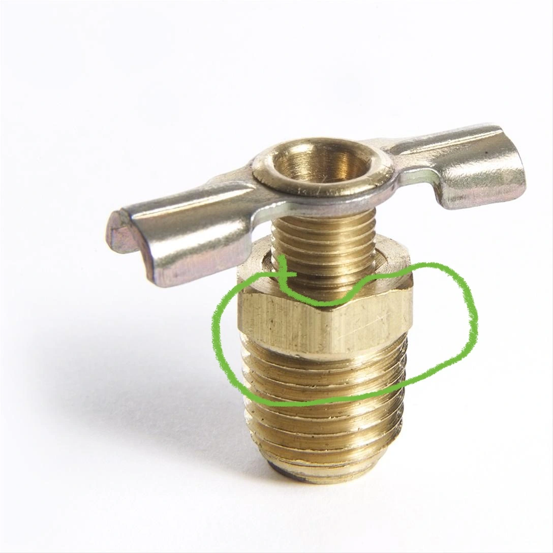

Are you unscrewing the wing nut? Or the hex nut under it to remove the valve. Wing nut just opens it to drain it.

Unscrew the outside.

Yea I’m unscrewing the wing nut. When it’s fully tightened in towards the radiator is when it allows coolant to drain out. But when I have it fully out away from the radiator or anywere between it has a constant drip. Also in the pic that’s as far as I can get it out with my hands. Is there something else I have to do to get it out besides twisting it or should I just put a wrench on it and twist it out? I don’t wanna break it so I haven’t tried the wrench yet but if that’s how it’s supposed to be done I will.

If it still leaks from the wing nut fully tightened you need to replace it, there like $5 just need to match the thread pitch if that's the new sve one, tell lmr to send you a replacement
when valve is closed, it should not drip. Its a valve, the valve isnt sealing, you cant fix it, its a machinig error or a internal o ring, see the part with the Teflon tape and the hex nut, unscrew that and tell them to send you a replacement drain valve.
