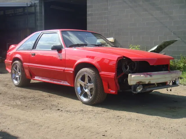

With 94-98 shafts a 17x9 with a +24mm offset will still sit inside the wheel well. They will be right at the edge with a 275. I'd run a Nitto since they run small that way you'll have the most clearance. IF you get Summitomo 275's they will have less clearance since they run wide.
Your best bet for clearance and overall look is a +45mm offset 17x9 wheel.
Not really a wheel type of pic, but this is all I got right now. This is a 97 axle with 17X9 +24mm and a 275 Summi. I'm going Nitto 275 once this beast is done.
And yes, the right side sits up higher than the left, and I don't know why. It pisses me off. Next year this things is getting brand new springs.
