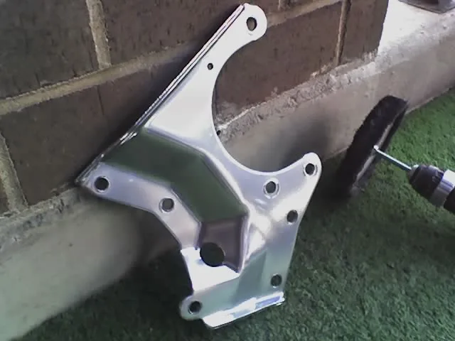

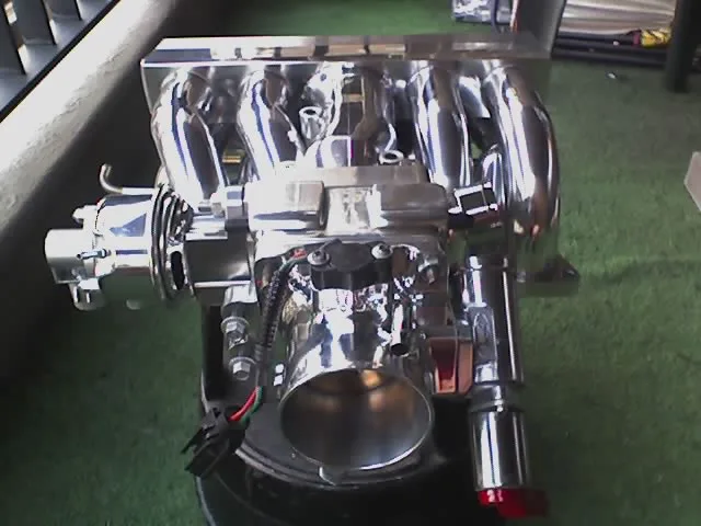

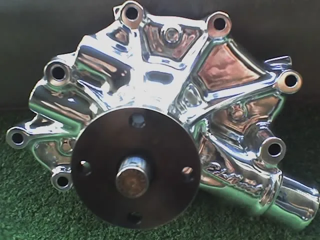

Thanks guys.
My process Squeezeandstroke is sand it down from 80grit, 120 grit, 220grit, 320 and lastly 400grit. Hand polish it with Mothers aluminum mag polish 1-2 times to get the inital shine, a low grit polish dull looking shine to it. The apply White Rouge (Eastwoods) on a hand drill that can maintain 3000RPM's 3-5 times or as needed. i like to use a canton flannel buff or a Spiral sewn buff on a drill. after hitting multiple times with White rouge, Wipe it down with windex to clear away black W/R residue and wipe and buff with a nice soft clean cotton sock on your hand. Its pretty simple, honestly-lots of practice makes it perfect. I can honestly say-I dont enjoy sanding or polishing, yet-Love the end results, and i only do it for myself and self gratification out of the love of hobby.
